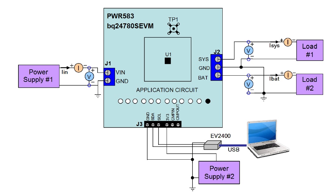

    Good day. I may know what's is your system set up? Below photo is our suggested test Setup diagram. You should need 2 power supply, one is 19V, the other is 3.3V. And did you install TI GUI tool to link with EVM board?

  • Hi Paul,
    I have connected 2 power supply as suggested in the user guide i,e one is 19 Volts & other one is 3.3 Volts.
    I have also installed Battery Management Studio for configuring the charger IC using SMBus. I have used eval board EV2300 to communicate with charger IC.
