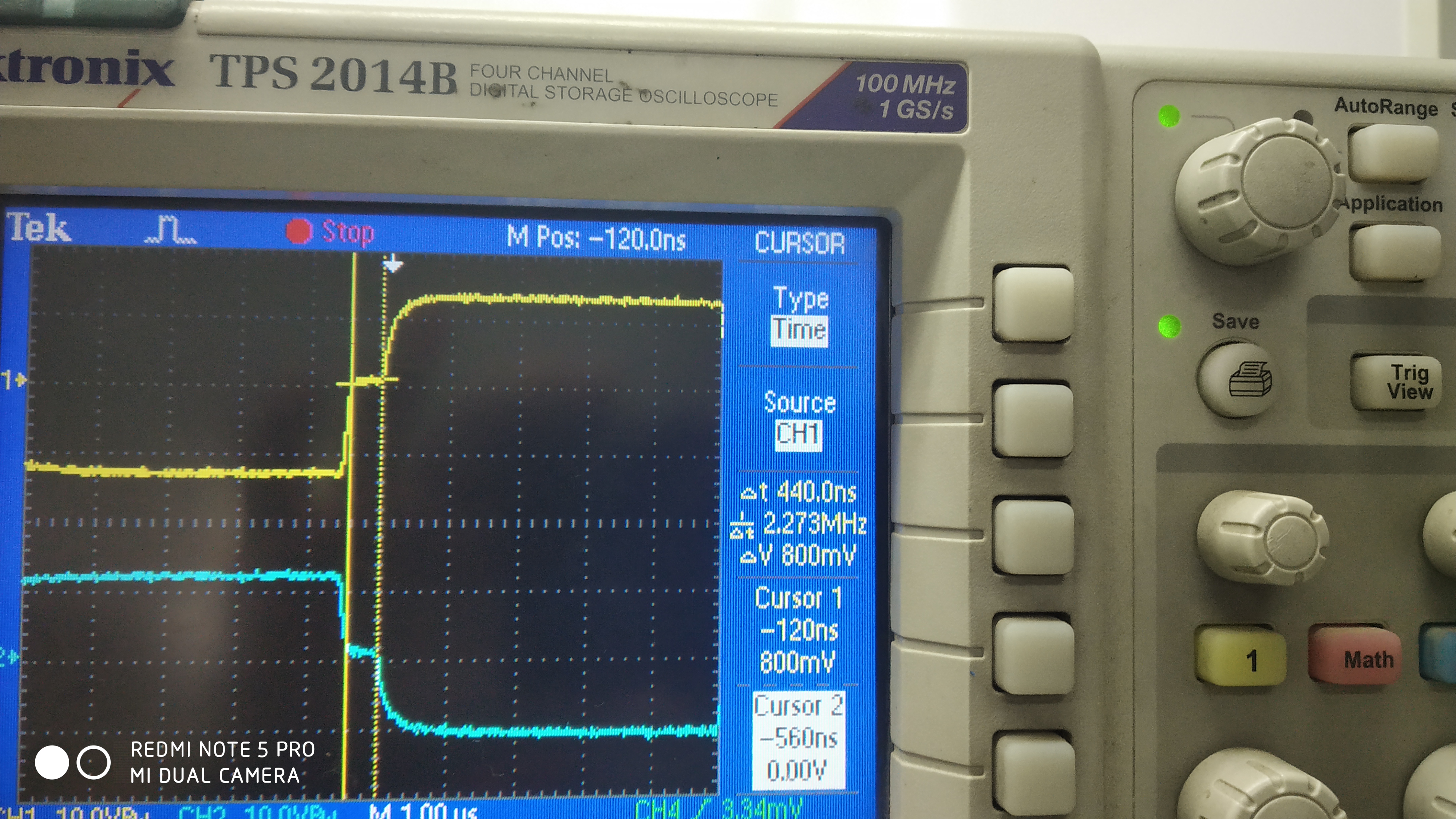

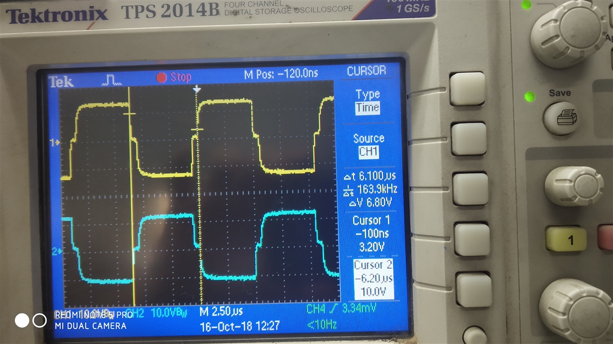

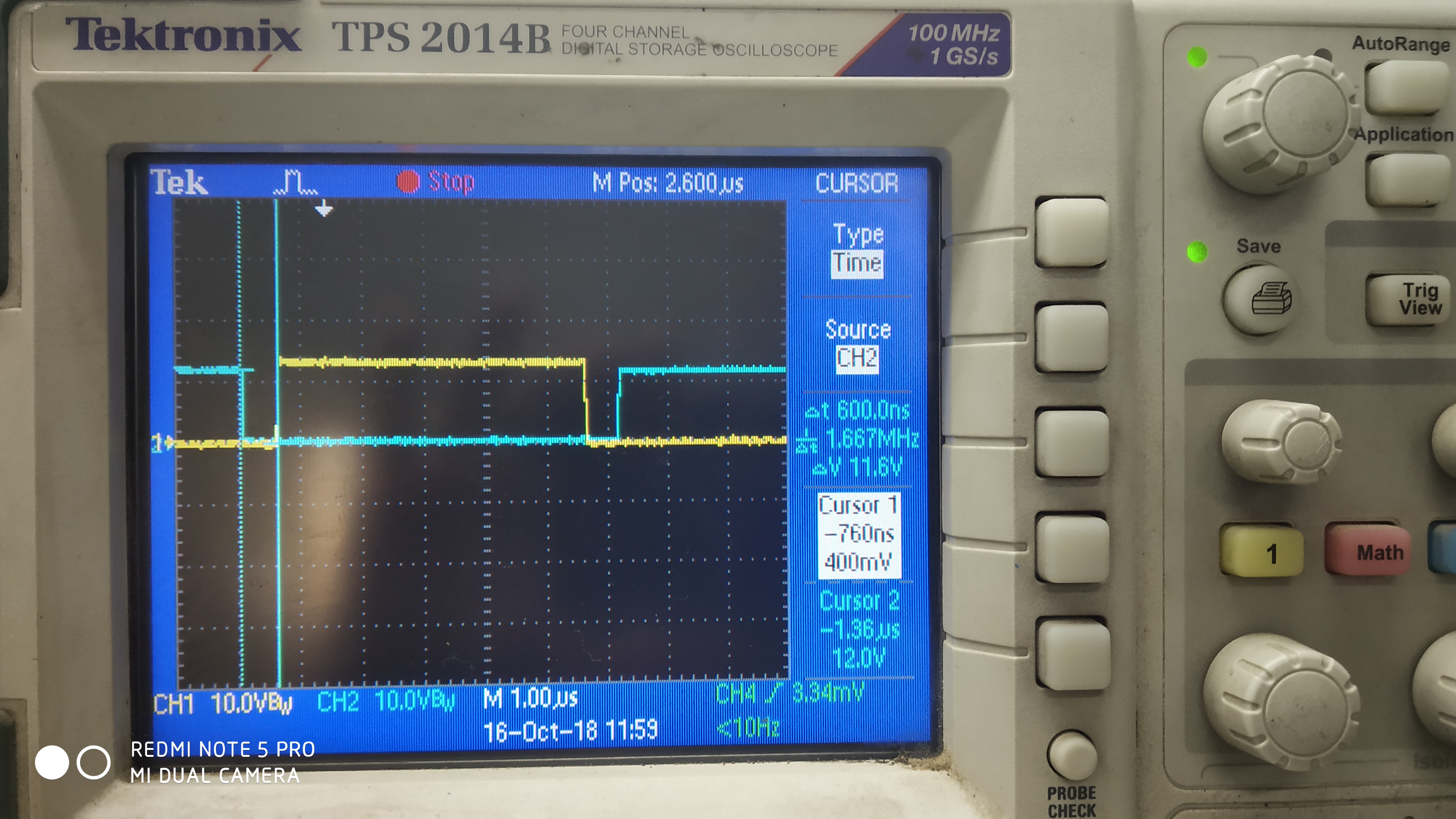

Dear Roberto,
Good Morning, have a great day ahead!
If I selected VADEL=0.2 then, as per your suggestion and calculations given in SLUA560C I got values as RDA1(R5)=8.25K, RDA2(R16)= 348Ohm, And if i want 600nSec delay then RDELAB= 52.5K (so selected 49.9K) is it OK?
Another thing, i used  ADELEF resistor network i.e. R6=8.25K and R17=348Ohm and R11=49.9K is OK? or i should change those values too?
