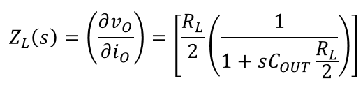

I'm actually working on stability analysis of a multi-outputs flyback controlled with UCC28740 and the feedback was obtained by a type 2 compensation network using Shunt regulator (TL432) and an optocoupler.
In order to complete this study, i'm needing the transfer function of the UCC28740 internal Modulator and of a multiple output flyback converter.

    For multi-output designs, we generally refer (by turns-ratio conversion) the parameters of all the outputs to a single dominant output and design it from there.  I imagine perturbations on other outputs must be referred to the one that is being regulated.

    I started by deriving the open loop transfer function for all 4 modulation regions. I have some points that needs clarification:
    - Slide 11 :  For the modulator + Plant Transfer function . The Ip/Ipmax ratio is clear for the FM control mode, but not so much for the AM region. and the Vcs_max should be the image of Ipmax on the CS pin?
    - Slide 12 : is neglecting the ESR value of the output capacitance could influence the results.
