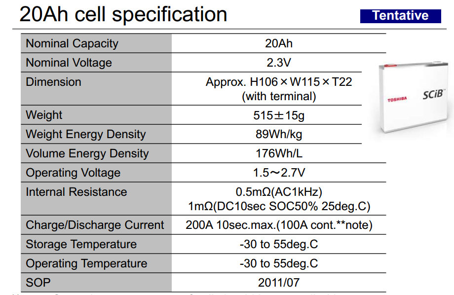

I have done two failed learning cycle with BQ40z80,when I finshed the learning cycle and relax for a at least 12 hours  i found that VOK never clear and LStatus() is still 0x05.
1. My cell type is TOSHIBA  20Ah SCiB, I use the chemical ID 0700, is that correct?
2. I follow below step to do the learning cycle, and stop learning when failed at step9. Please see my log data attached.
Step1: Program  with correct chemical ID, correct data flash.
Step2: Calibrate the battery pack.
Step3: Discharge the battery pack to empty with C/10 (voltage down to term).
Step4: Wait 5 hours.
Step5: The [VOK] and [RDIS] bits in the IT status() register clear, GaugingStatus[REST] flag is set .
Step6: Charge pack to full with C/4 until the taper current is reached and the FC bit is set.
Step7: Let it relax for 5 hours.( Update status  05)
Step8: Discharge the pack down to term voltage with C/10.
Step9: Let it relax for 12 hours.( Update status  05,vok not clear)1256.learning cycle.zip
