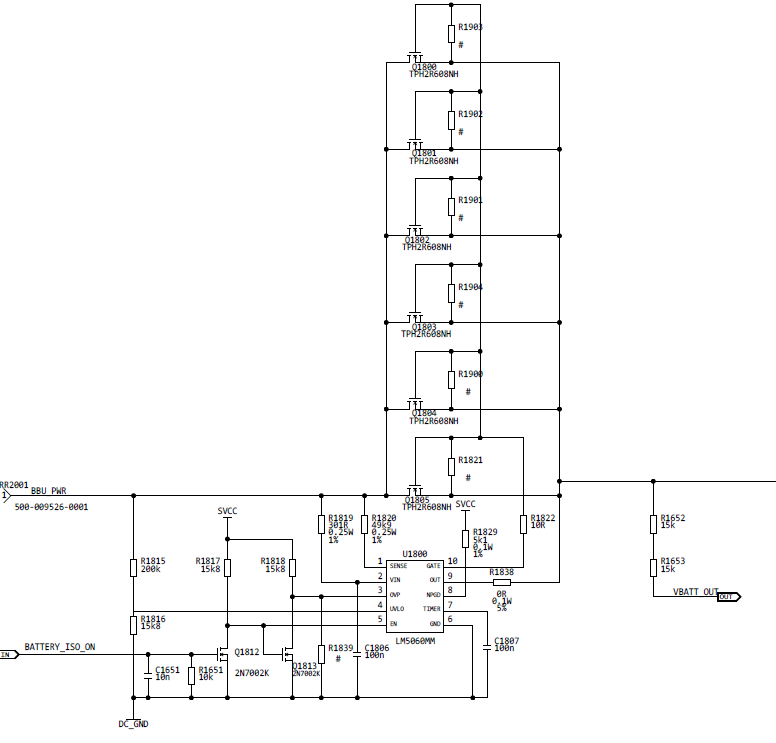

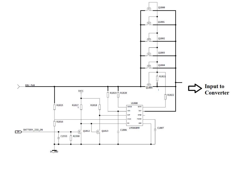

I received an inquiry from our customer when they used our LM5060. Below is the summary of the application and issue they are facing.
We are using LM5060 to drive 4 Fets- act as switches.
I set the OCP to about 160A.
Upon reaching that level, I observed that, instead of latch, the gate drive retry and end up damaging the FETs and the LM5060.
BBU_PWR comes from a DC Source.
Q1800 to Q1805 are Power FET that connects the BBU_PWR to the converter.
In case of any fault in the converter the Q1800 to Q1805 will disconnect the BBU_PWR to converter.
 Can you help provide feedback why they are facing the failure?
