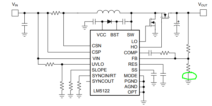

Hi Team,
If I was to place a FET in series with the feedback resistors for the LM5122-Q1 to have 0A of Iq during low power state, would this be acceptable? If it is acceptable, are there any risks to consider? Also, where in the feedback path should the FET be placed?
Thank you in advance for your support!
