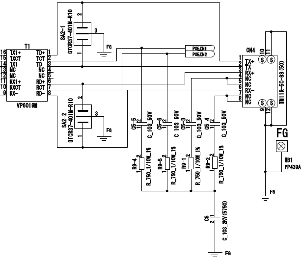

I would like to design the PD side to work with only Alternative A.
Because our system is used only Alternative A.
In this case, the connection of the pins used by Alternative B is connected as shown in the attached figure.
Is there no problem?
