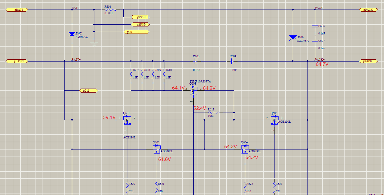

The BMS is made up of bq76940,bq78350 and bq76200.
Everything is ok.
Now, the charge voltage is 65V and there are 15 batteries at all.
However, the charge current is too low, and it's only almost 30mA.
What's the problem?

  • Hi Wu,
    The current does seem low, if your 15 cells are about 59V as shown above and the applied charger voltage is 65V, for 27 mA the path resistance would be about (65-59)V/.027A = 222 ohm. Something seems off.
    If both FETs are off and you are charging the DSG FET would act as a diode dropping perhaps 1V. However 27 mA seems like a lot of leakage if the charge FET is off. Measure to find the voltage drop, that should indicate where to look for the issue.
    Check across various connections and components with a meter to find the voltage loss, perhaps something is not soldered or connected tightly.
    The display shows the CHG and DSG should be enabled. Check voltage of DSG and CHG out of the bq76940 to see that it is high. Verify they make it to the DSG_EN and CHG_EN of the bq76200. Also check the DSG and CHG of the bq76200 with respect to battery+, and across the gate-source of the charge and discharge FETs.

    Just have a look at the voltages listed as below:
    Do you have any suggestions?
  • In fact, when a load is added without the charger, the load can work well.
    Besides, the load current can be up 1A during the testing process.

  • Hi Wu,
    From the voltages the pre-charge FET is on, the charge current will be limited by the parallel combination of the resistors (R607...), about 300 ohms. Looking at the bqStudio register view in this condition should show the PCHG bit in Operation Status set rather than CHG. Check the cell voltages and configuration of the precharge voltage thresholds in the bq78350 technical reference manual (TRM). The TRM was updated recently, please be sure you use the latest one. The update clarified a number of confusing points.

  • I have checked all settings. The charging current is made up of pre-charge and charge . Just remove Q603 and the charging current will drop to 10mA. I just can not understand why the system enters pre-charge state. Besides, I have gauged all cell voltages and they are all around 4.0V.

  • During the charge process,the current from the "fast" charge seems constant,which is almost 10mA.When reducing the resistors' combination(1.2K), the charge current will arise.However, bqstudio just show "FCHG".Besides,the LEDs are not on during the process,which can be on during the "boot" process.LED_EN and LEDCHG have been set. Does this means the process is pre-charge?
  • Thank you very much.
    In fact, the N-MOS has been destroyed.
    Just change a new N-MOS and everything is OK.
