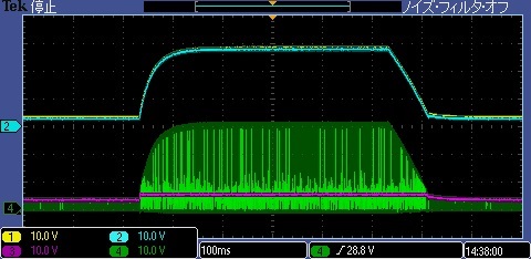

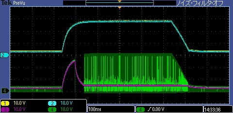

Customers evaluate using LM43601.
They evaluate the instantaneous interruption of the input voltage, but when the VIN changes as follows, the occurrence frequency is low but problems may occur.
They set the output to 5V.
- VIN
28V -> 3V -> 28V -> 3V
- VOUT
5V -> 2.5V -> 26V -> 5V -> 2.5V
When VOUT rises to 26V, SW seems to be fixed to the input power supply ON.
We want to know why such a phenomenon occurs.
Please tell me what kind of condition the LM43601 will cause this phenomenon to occur.
The waveforms at the time of normal operation and abnormal occurrence are shown below.
Yellow - Output of regulated power supply
Blue - VIN
Purple - VOUT
Green - SW
10V/div,100mS/div
Normal
Abnormal
