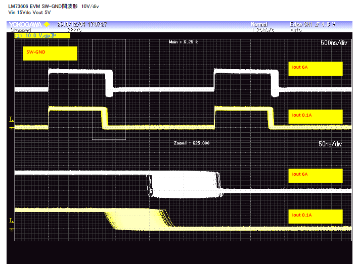

Hi team,
I'm an FAE supporting some industrial customers in Japan.
Please let me ask you about LM73606EVM.
Switching node of LM73606 was fluctuated when falling as shown in below.
Is this normal operation for this device?
Operating condition:
Input Voltage: 15V
Output Voltage: 5V
Discrete component parameter: default
Iout: Upper is 6A, Lower is 0.1A in below image. Both of them are constant current
I'm looking forward to hearing back from you.
