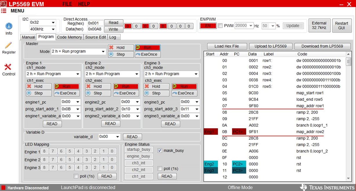

  • Hi, David,
    You don't need to modify the map address and realize it as the following code:
    2376.LP5569_Example.zip
    By changing the ENGINE1_PROG_START value through I2C after stopping engine can change to another map address:
    In above figure, 07h represents map_addr row1 and 0Bh for row2.
    You may also try ra rb and je for this purpose.

  • Hi Kenneth,
    I am clearly missing something here. I have tried to increment the number of loops to have 5 different entry points to control the 5 leds with the same effect.
    The two first entry points work fine, but the rest do flash erratically
    This is the code I am using LP5569_Example_5_LEDs.src.zip, and the entry memory locations I think should be correct :
    LED1: 0x07h
    LED2: 0x0Bh
    LED3: 0x0Fh
    LED4: 0x13h
    LED5: 0x17h
    When you say stop the engine, this is what I am doing:
    1. Stop engines sending Engine_Control1 (Reg. 01h) and Engine_Control2 (Reg. 02h) to Hold and Stop engines.
    2. Change the entry point for Engine1 (Reg. 48h)
    3. Re-enable the Free Run and Run engines via Engine_Control1 (Reg. 01h) and Engine_Control2 (Reg. 02h).
    Am i missing something obvious?
