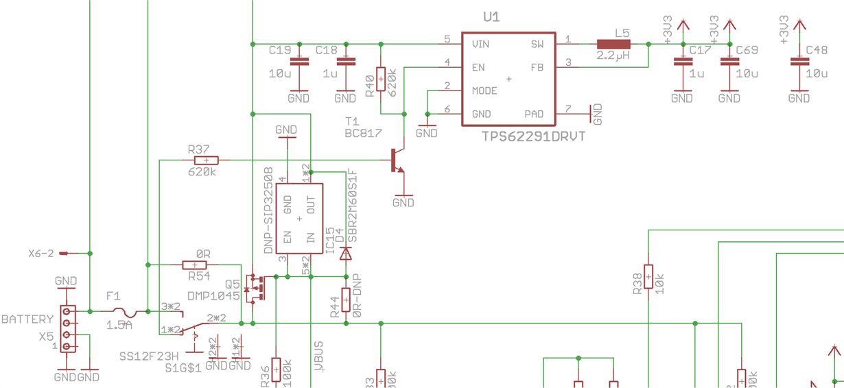

HI,
In my project I use the TPS62291 to convert the input voltage of 5V (USB from Raspberry PI) or alternatively 3-4.2V from a LiPo cell to 3-3.3V for some sensors and a microcontroller (max. 200mA). It's working fine, but of the first series of 50, two devices came back with failures. They worked when they were new. It seems like just the low side MOSFET is blown, because with diode testing range I measured 75mV between the OUT pin and GND. And the device part 3.3V for few seconds, before it heats up and runs into thermal protection. After exchanging the part, the two devices are working well.
Can you tell me a possible reason for such failure? By the way, the 48 other devices are working for months with no problems.
Thank You.

    To support you, I need some info. Is it possible to have the schematic and layout of your application? Which kind of test you did? Also know the conditions and environment of your test can help me.
  • Hello Alfonso,
    here is the part with the TPS62291. The whole schematic is much bigger. The inductor (L5) is Taiyo Yuden  CKP32162R2M-T. There are several 1µF capacitors around the PCB on the 3.3V net. The parts marked with "DNP" are not populated.
    we are looking at your schematic and layout, and I will back to you soon. Can you please give details about the test you did and the relative conditions? Can you provide the measurements data? It helps to understand the behavior of the device.

  • Hello Wladimir,
    Your schematic and layout seem ok. Usually, this problem is caused by an overvoltage at the switching node (SW) due to an overvoltage at the supply or attaching measurement equipment. With USB there is the risk of overvoltage generation by plugging in/ unplugging.
