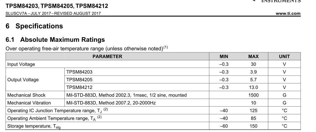

Is there drop and vibration test data for LMZ23601?

From what I've seen the drop and vibration test (MIL-STD-883) are military grade specs. The LMZM23601 device is was designed for ordinary catalog not military grade rating. Attached is the product reliability document that this device has been tested for.

What is your initial conditions (VIN/VOUT/IOUT)? I don't think there are any nano-module that have been tested for MIL-STD-883 specs. An alternative to this is our leaded modules portfolio that have a few devices specd for this standard such as the LMZ10505EXT and the LMZ14203EXT.

Vin=24V, Vout=5V, Iout=1A
Because it is required to be very small size, LMR23601 is the best product.
I understood that there is no shock and vibration data.
