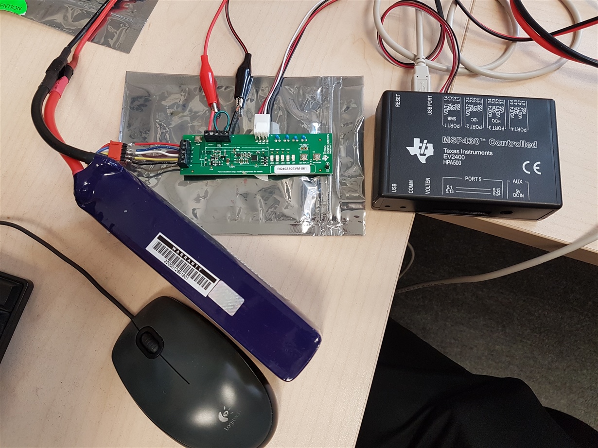

    My apologizes for not clarifying. I am using a 4-cell battery, so setting the system voltage to 16.8 is appropriate. I have shorted SYS_PRES to GND, but there is still no response from the chip.
    Please see the images below for further clarification:
    Image 1: Current Setup of the EVM
    BQ40Z50-R2 Setup

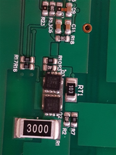

    Image 2: Defect in the EVM? Q3 is a little off center...

  • If you're still not getting the evm to communicate when powered up both on BAT and PACK side, please open bqstudio. Open the advanced smbus comm panel and then read from word 0x0d. If it NACKS you have a bad board, if not, please flash the srec file located in the bq40z50-r1 or r2 page using the firmware tab and then click on the execute button. That should wake up your evm.

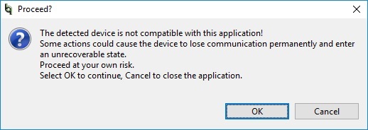

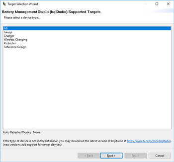

    How do I open the "advanced smbus comm panel"? The welcome screen I see when I open the BQStudio doesn't show me that option. Below is the screen shot of the welcome screen.
    I am under the impression I have the correct SW installed for the BatteryManagementStudio (version 1.3.54.1) - package sluc525u.zip... perhaps not?
    Thank you,
    Michael
  • Click on gauge, click next, select the bq40z50. Then you will see the register panel for the gauge open. One of the buttons in the menu is the advanced comm smbus button.
  • Hi Batt,
    Following your instructions, I selected "Gauge" and then "bq40z50" and then clicked "Finish"
    The proceed error appeared (same as in my previous post and shown below):
    But I clicked "OK" anyway.
    I then got to the main panel, and selected the "advanced comm smb" tab. The result from reading "0x0d" is "error" and can be seen in the screenshot below.
    Does this confirm that the EVM is not working? If so how do I proceed?
    Thank you,
    Michael
  • Yes, this confirms that your evm is dead. Please replace it with another.
