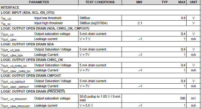

I am using BQ25700A charger IC in my Design. In the datasheet, the leakage current is mentioned as 1mA for (SDA, CHG_OK)pins. I am Using the 100K ohm resistor in my design. If I am calculating the Voltage across the pin it is found to be 100mV (V=0.000001*100000=.1V). The leakage mentioned in the datasheet is milliamps or microamps.
Could you suggest me is datasheet specified is correct or a typo error?
