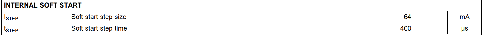

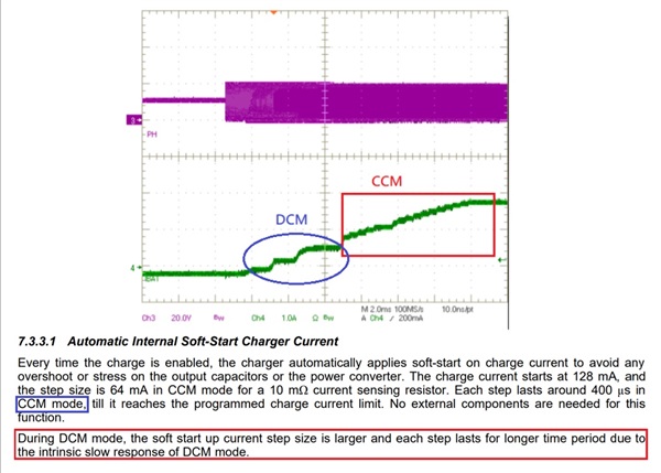

Hi expert,
My customer has a question on soft start for bq24780S. From below picture, it seems like the step are different between the current 1(64mA) and 2(about 500mA). Is there another soft start step or is it another mechanism for charging current soft start? Thanks a lot!!
