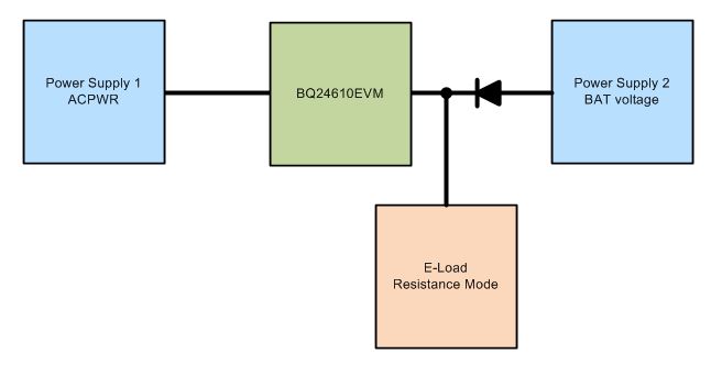

  • Hey Mo,
    Feel free to use two power supplies and your DC E-Load for this test. Please see the configuration below:
    Power Supply 1 is your input.
    Power Supply 2 is generating the battery voltage but if the charger works correctly, it will not source current into the E-Load. In case it is the EVM for some reason, I would limit set a current limit on Power Supply 2.
    E-Load should be in resistance mode and set to a low resistance value. This will be sinking the current a real battery would while PS2 is supply the "cell voltage".
    If you see PS2 going into current limit and E-Load 1 not providing current, it could be something wrong with the EVM. Also try moving the PS2 voltage up and down while monitoring the voltage on VBAT (TP9). If VBAT is at or near 21.1V, you will likely see little to no current from the charger into the load and PS2 will start sourcing current into the E-Load.
    This should clear up whether this is a battery or charger problem.
    Joel H
    I did a battery full charge using a PSU (at 1A)  until the lockout enabled, then fully discharged it at 1A using the E-load test (CC) again until the batteries locked out. I then again did a full charge using the PSU but this time made sure to charge at 2.6A.
    After that I then connected the battery to the EVM, this time round the battery worked correctly and the STAT1 LED turned off and the STAT2 LED turned on.
    I followed your instructions given in your last post for the EVM test, but the charging did not enable.
    I set the voltage on PSU2 as 18V and the current as 0.8A. The E-load was set to CR (Constant resistance) at 30 Ohms. The diode used are UF4001 (1A rectifier)
    Is it possible that the properties of the battery changed during the charging cycle, and caused the EVM board to function correctly?

  • Hey Mo,
    It is difficult to say what changed. Perhaps a protection circuit in the battery pack tripped and wouldn't allow the pack to accept current but that is speculation.
    As far as my test, two notes: I should have been more specific with the value of "low resistance" in that 30-Ohms is too large given the current. If you push 1A into the E-Load, the voltage will try to shoot up to 30V. By low I mean less than 15-Ohm give or take.
    The second thing is that in using the power supply, you do not have the battery thermistor connected. You will need to apply a 10k to TS and GND in order to mimic a thermistor at a normal temperature.
    Joel H
    It now started to work well, I did made a change to the resistor value to 887K this helped to resolve the issue due to the original setting being too high.
