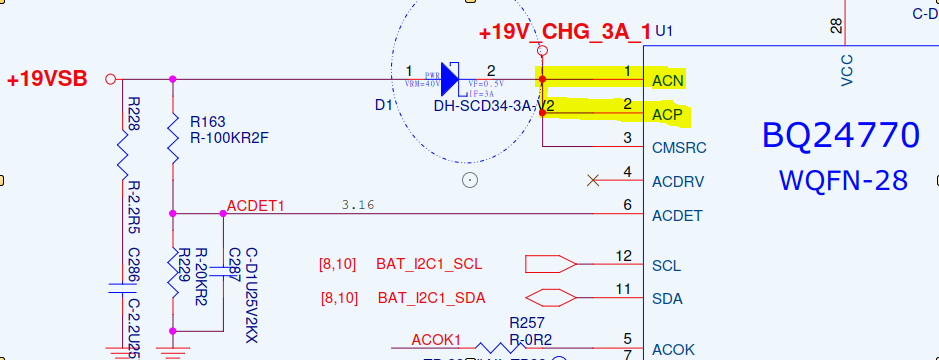

Hi Team,
We found the LSFET is always off and hot at high current condition when ACP/ACN pins are shorted together.
Can we disable the Light_Load comparator by SW? or any other workarounds? Thanks!
Sam Ting
  • Hi Sam,
    The only software control of the light-load PFM mode is the Out-of Audio Bit (register 0x12, bit [10]). Setting this won't take you out of PFM mode, but it will force the PFM to a minimum frequency of 40 kHz (to reduce switching noise in audio range.) I don't know if that will help or not as this isn't a configuration that we test, but you could try it. Even if doing this appears to help, there may still be unforseen consequences of removing R_AC, and I would still recommend that you add R_AC into your power path and connect ACN/ACP.
