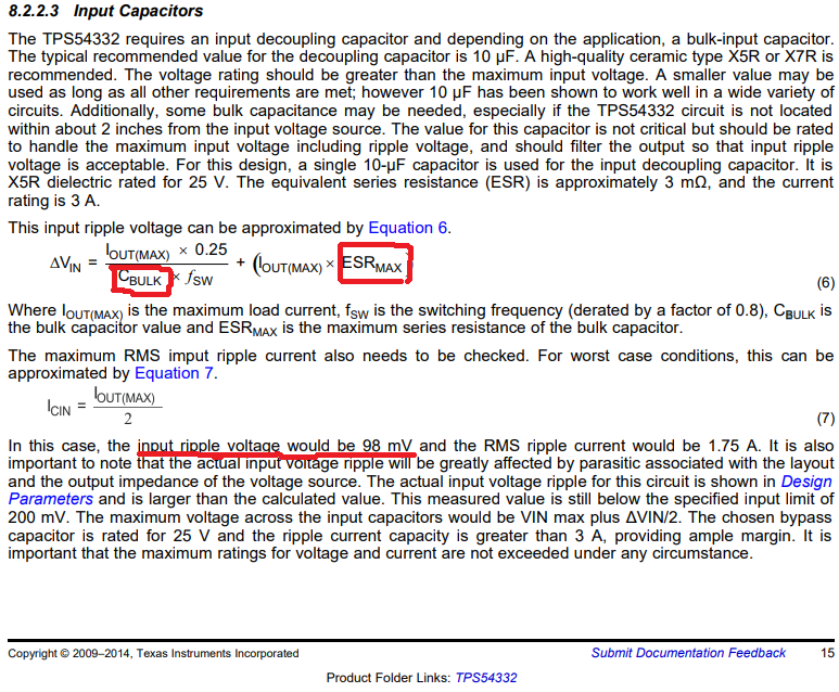

Hi, I was working through the design example in the datasheet.
My question relates to section 8.2.2.3 "Input Capacitors".
It's not clear how the 98mV Input Ripple Voltage was calculated.  The equation that should be used (see below) would be related to a Bulk Capacitor.
Only the 10uF Bypass Capacitor is being used in this design example.  Can someone help me understand how the 98mV was derived?
Brian
