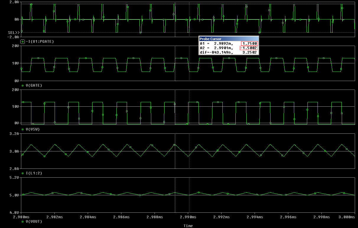

  • Hi Aidan,
    Thanks for the feedback. We have implemented the Gate Driver Output Source/Sink currents properly. Below is the steady state simulation result of released test bench. To test peak source/sink Gate currents, we have connected additional 20nF capacitor at Gate node to Ground.
    Simulation Result:
    [NOTE: I(U1:PGATE) and V(GATE) are the current through and voltage at PGATE pin respectively].
    Also, could you please attach your test schematic here? This will help us to analyse the issue regarding VCC pin current.
    Thanks & Regards,
    Arpan Gupta

  • Hi Aidan,
    Gate driver output Source/Sink currents are not modelled in the model you are currently using. Therefore, you will not be able to see proper results. Now we have implemented Gate driver output Source/Sink currents in the model. We have shared the updated simulation result with you on 07FEB2019. The updated behaviour will reflect after we release the updated model to TI website.
    Currently we are resolving the current limit issue for higher input voltage cases. You will find updates on this at below thread.
    https://e2e.ti.com/support/power-management/f/196/p/755044/2854404#2854404
    We are trying to resolve the current limit issue as soon as possible and targeting to release the final updated model (with both bugs fixed) by end of this month.
