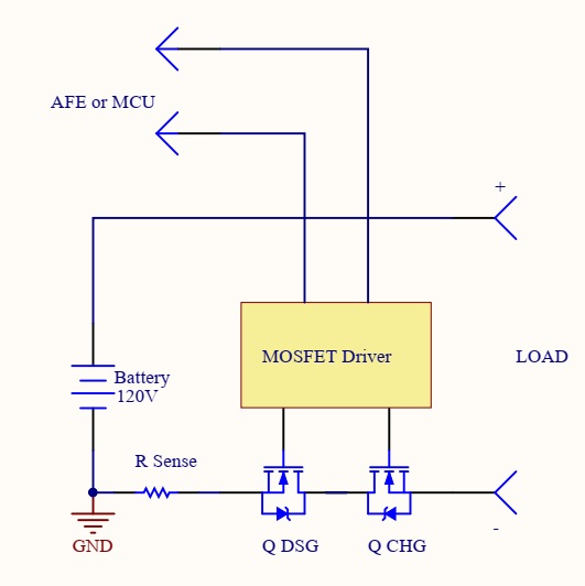

  • Hi Mamadou, I read your article about replacing relays with transistors, good article, thank you. In my case, the situation is somewhat different. Transistors will be used on the low side.
    Here is a simplified block diagram.
    And I'm worried about how I better supply power to the driver, and whether the driver will burn from the high voltage on the Mosfets.
  • Hi Alexey,
    Thanks for your feedback and follow up questions.
    This topology would not work due to the fact that load negative terminal may swing well below GND level(commonly occurring in battery packs systems) when CHG is not being pulled high. This could forward bias the internal body diode of the charging channel driver's output stage.
    Adding a discrete P-channel FET to the to CHG path may help prevent the voltage from LOAD(-) from reaching the driver's output stage.
