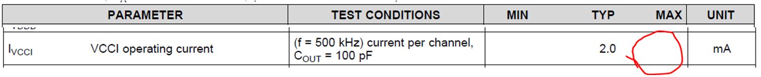

Q1 - is there a max value specified for IVCCI in operating? Only typical value is specified.
Q2 - in datasheet, typical IVCCI is specified at 2.0mA under test conditions of "(f = 500 kHz) current per channel, COUT = 100 pF" ==> can elaborate? is this condition under 0 output current with freq = 500kHz?

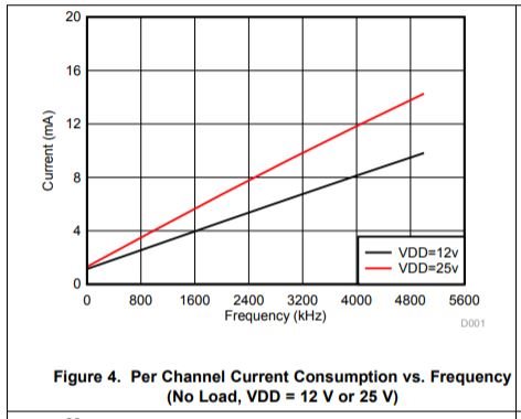

Q3 - is below curve referring to IVCCI or IVDDA/IVDDB?

    Q1- IVCCI(max) is not specified but should not vary by a big margin.
    Q2- IVCCI or "operating current" is the VCCI current consumption (per channel) when a 500kHz PWM input signal is applied to ChA/B with a load capacitor (100pF in this case) at the output which is different from quiescent current when the VINA = VINB = 0V and no load connected.
    Q3- Figure 4 represents variation of the operating current IVDDA/B over frequency at NO LOAD.
