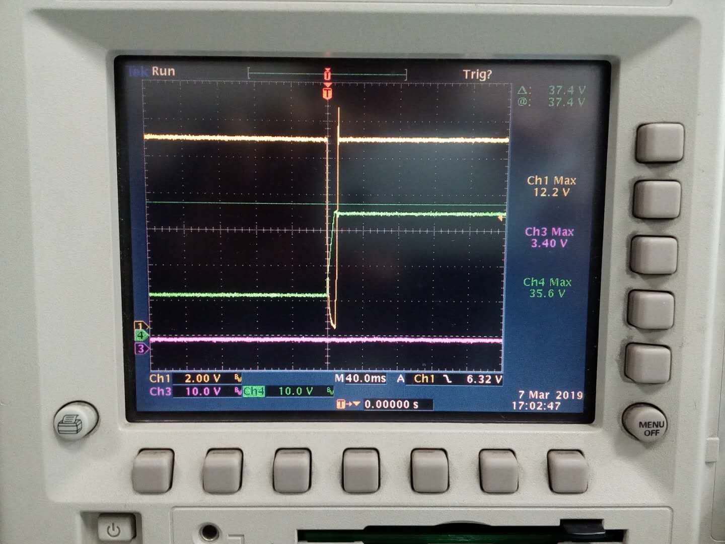

Dear Sir,
We use application note ( slva306a ) to do PoE Priority Circuit Using Controlled Adapter High-Side Switch (as below circuit). But Vout will drop when Adapter supply first then PSE plug in (as below waveform ; CH1: Vout; CH4 VDD1). Do you have any suggestion for Vout drop issue?

  • Hi Sam,
    This circuit is not intended for smooth transition from adapter to PoE input. The PoE input will take priority, but the adapter input will turn off at Vdd-Vss = ~30V before the PoE input exceeds the rising UVLO (36V) to turn on the hotswap FET.
    If the customer needs smooth transition between adapter & PoE input, I recommend using the example in section 3.6 of SLVA306A or modifying our hitless transition design, PMP20859, to use a single channel instead of 2.
