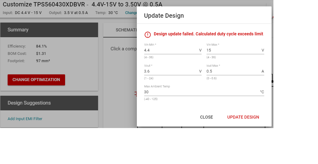

if the input and output voltage is close, for example, one is 4.0V, one is 3.6V. for the duty cycle limit, many DC/DC converter will not work. does TI has a convert like Diodes AP63200, which can work like an LDO when in input voltage goes down very close to the output voltage.
