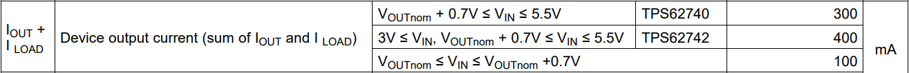

    I would like to bring to your attention how much current you are advised to draw from your device under different voltage conditions:
    How much current is your application drawing?
    Additionally, the TPS62740 has a 100% mode, which is automatically activated when the input voltage is close to the output voltage. To understand that more, please refer to section 9.4.2 in the datasheet and to this application note (slyt747).
