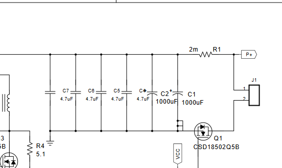

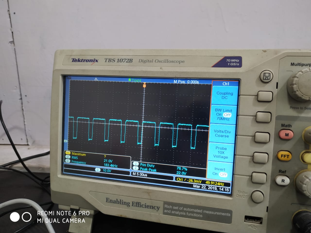

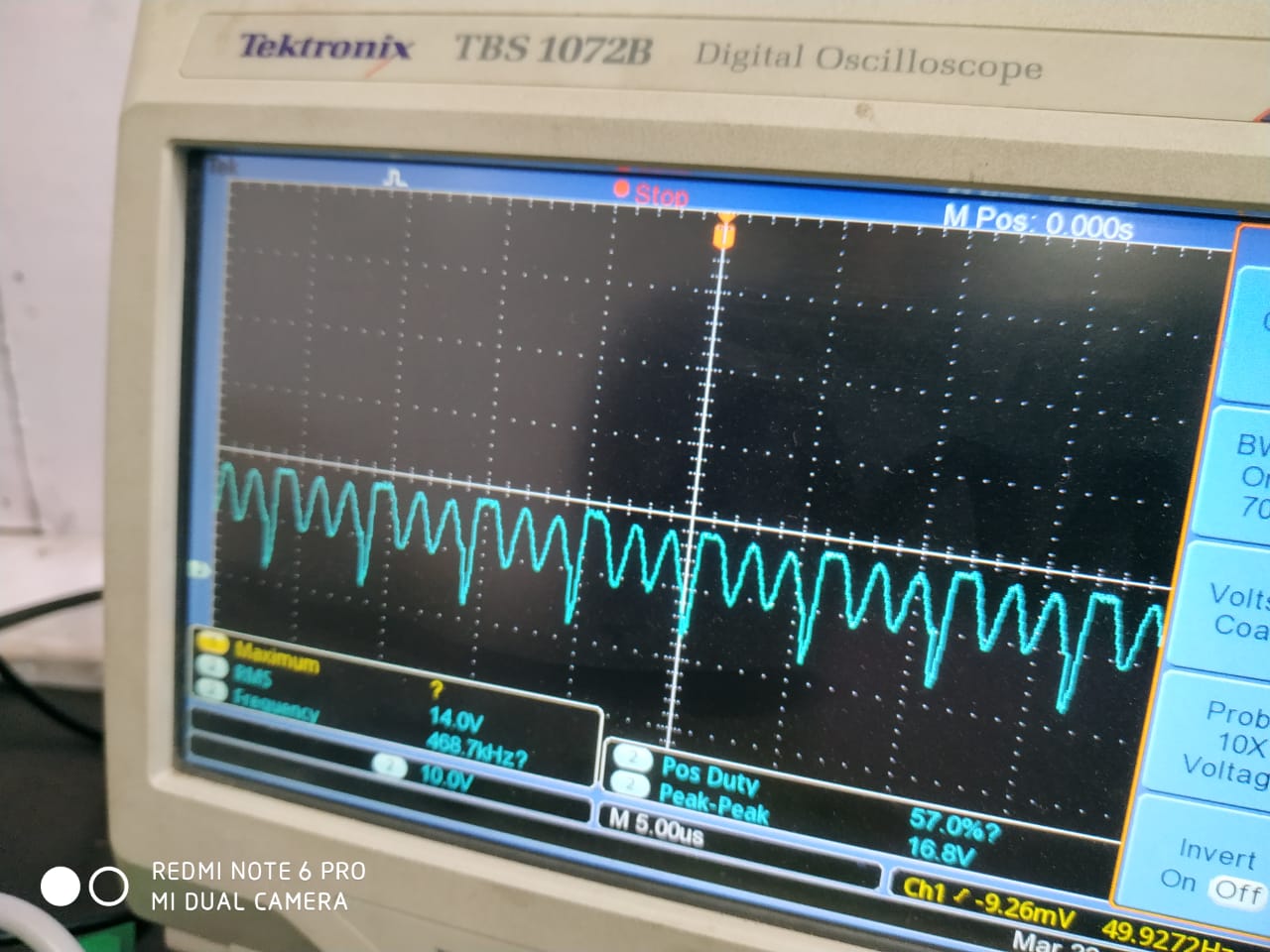

I am getting an issue in some cases, The output of HOA is getting distorted same as HBA and HSA , not getting proper ground . and after replace of SM72295 HOA output is getting proper ground.
  • Hi Sanjay,
    Sorry to hear you are having difficulty with our device. What values do you have for C5 and C6 on the first page of the data sheet?
  • Value of C5 and C6 is 4.7uF/50V

    I understand that these are waveform's of HOA output when SM72295 is damaged and when replaced. The damaged HOA waveform has a slow rise/fall time and only has the ability to drive about 1us. After 1us the HOA output oscillates possibly from the high-side driver supply not driving it correctly. We need to make sure the driver supply has the right capacitor values on HBA-HSA and VSSA-PGND. What is the bootstrap and VCC capacitor values of side A?  is side B of SM72295 also have the same issue? is this a solar charging application? what is the load current?

  • Hello sir
    Yes i am using for solar charging application , bootstrap cap value is 1nf and the load current is only 5A . I am not using Side B , i am using only side A and side B is Normally open.
  • Hi Mitesh,
    thanks for your update,
    Please check out the first page of the datasheet (www.ti.com/.../sm72295.pdf) which has a typical application circuit with typical values for the bootstrap and VCC capacitors. Typically, the bootstrap cap should be 470nF and the VCC cap should be 1uF. This should help with the ringing your seeing, which could be an LC ring from the 1nF bootstrap cap and a similar 1nH parasitic inductance in the bootstrap turn on path. Please let me know if changing these capacitor values helps your issue or you have any more SM72295 related questions.
