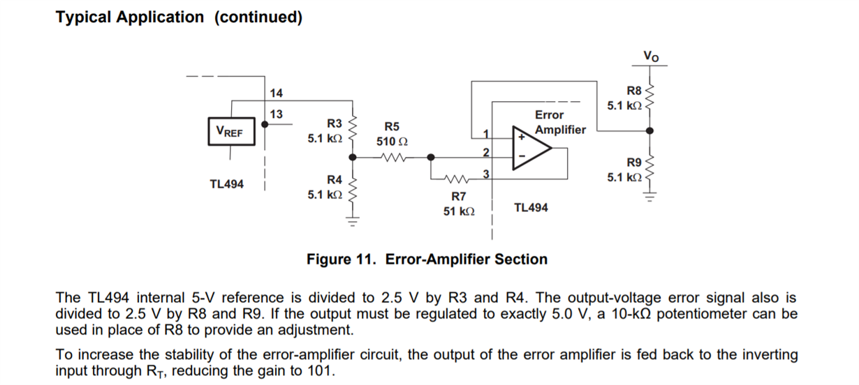

The voltage feedback loop suggested in the datasheet doesn't include an integrator. Is there a specific reason why we should use only gain controller for TL494 or is it okay to use a PI compensator for the voltage loop. Is Rt mentioned in the text is referring to R7 in the image? Also, wouldn't the gain be reduced lower than 101 as the thevenin resistance of R3 and R4 will come in series with R5?
