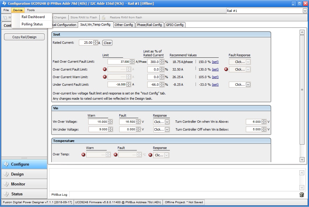

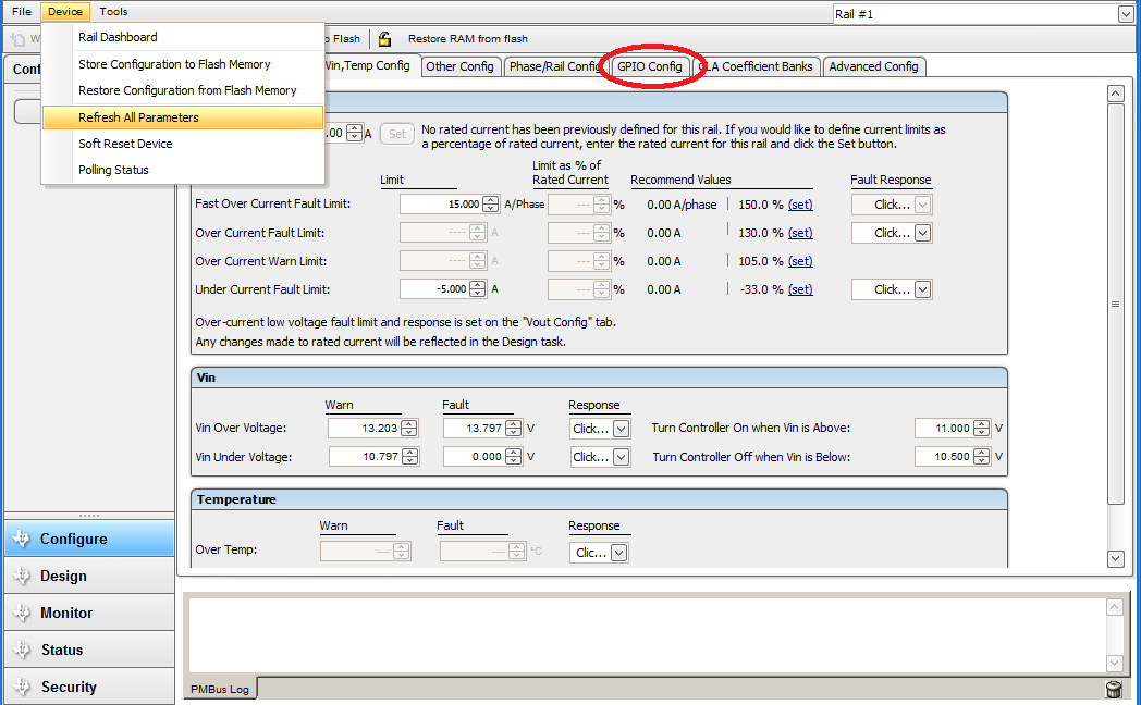

Hello. I have designed a power solutions with two UCD9248 (with descrete drivers UCD74120) working as a system. I would like to describe issues that I have faced.
1. The first system I started as offline project in the FUSION_DIGITAL_POWER_DESIGNER v7.0.1 did not have some functionality: sequencing inputs (in my case PIN 53) did not show up in Sequencing Dependencies menu for the rails. Then I have tried an older  version of the FUSION_DIGITAL_POWER_DESIGNER v2.0.179 and it worked just fine!

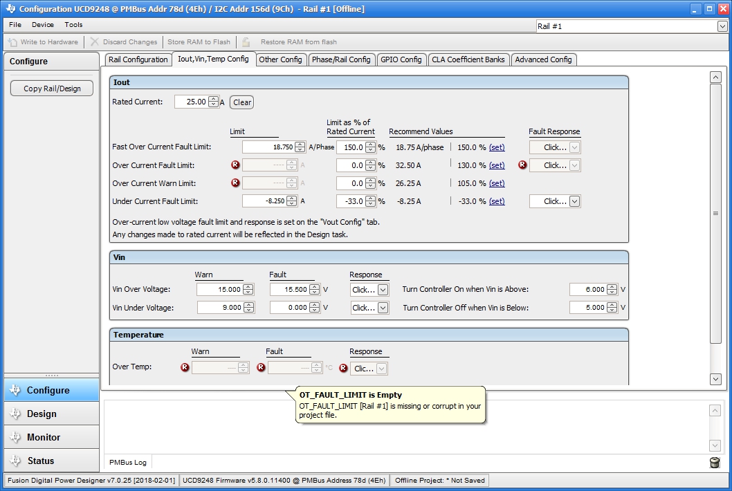

2. The second system is not done yet but I decided to upgrade FUSION_DIGITAL_POWER_DESIGNER to newer v7.0.25 that at a first glance did have some improvements. Unfortunately at some point project was ruined and following registers according to software were empty: IOUT_OC_FAULT_RESPONSE, OT_WARN_LIMIT, OT_FAULT_LIMIT, OT_FAULT_RESPONSE.  I have tried to compare different projects with and witout this error but it seemed that files had those lines. Problem continued with the latest version v7.1.1. Problem was solved when I opened corrupted project in the older version v2.0.179 that just filled all registers with default values.
Please take a look at the picture.
What version should be actually used in the design? Looks like the only way to go is v2.0.179.
