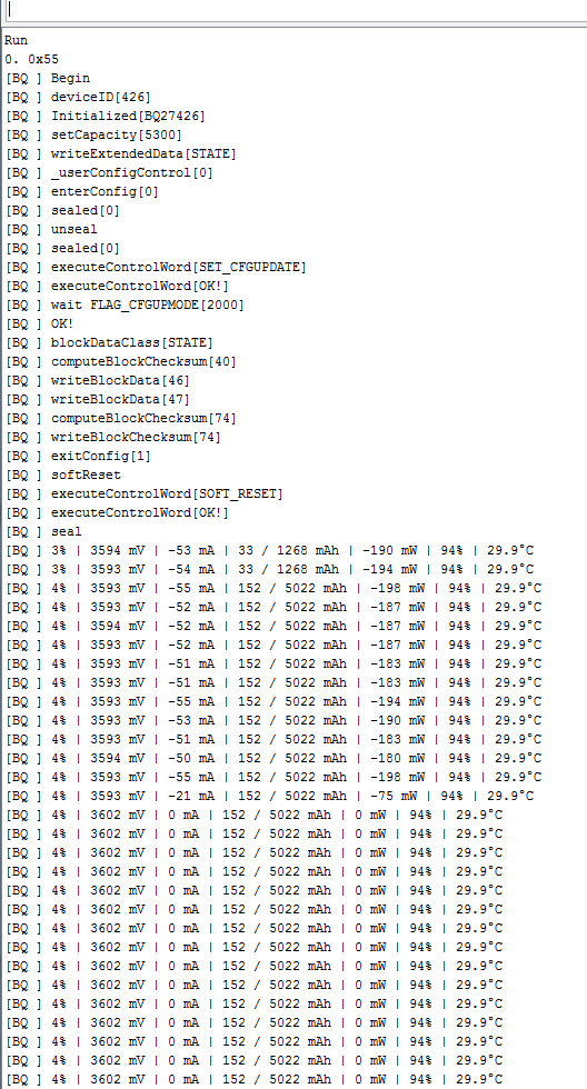

Debug console output is attached:

    2 new questions from the customer related to BQ27426 at that projects.
    1)     The customer uses the following structures to set-up design capacity. These are different and depends on chip:
    static struct bq27xxx_dm_reg bq27421_dm_regs[] = {
    [BQ27XXX_DM_DESIGN_CAPACITY] = { 82, 10, 2, 0, 8000 },
    [BQ27XXX_DM_DESIGN_ENERGY] = { 82, 12, 2, 0, 32767 },
    [BQ27XXX_DM_TERMINATE_VOLTAGE] = { 82, 16, 2, 2500, 3700 },
    static struct bq27xxx_dm_reg bq27426_dm_regs[] = {
    [BQ27XXX_DM_DESIGN_CAPACITY] = { 82, 6, 2, 0, 8000 },
    [BQ27XXX_DM_DESIGN_ENERGY] = { 82, 8, 2, 0, 32767 },
    [BQ27XXX_DM_TERMINATE_VOLTAGE] = { 82, 10, 2, 2500, 3700 },
    The customer tries to set-up BQ27426 design capacity with 5300m but the ic returns 5022 (see screenshot below). Is this OK or not?

  • The 5022mAh is the Full Charge Capacity. This will be different from Design Capacity, depending on gauging settings.
    Design Capacity is the nominal capacity for this cell. The gauge treats this as the total charge that can be stored in the cell from cell = full (depth of discharge = 0.0) to cell = empty (depth of discharge = 1.0).
    FCC is the actual total charge that you can withdraw from the cell under the system's load, charge and temperature parameters with cell age also under consideration.
    This will be less than Design Capacity. For example, if the cell isn't charged to DOD = 0.0 but to DOD = 0.05 (for example, charging voltage is not the maximum allowed or taper current is fairly high), FCC will be less. Or if temperature is cold (e.g. 0C), FCC will be less. Or if the system load is high (e.g. C/1), the IR drop due to the high load current will cause the cell voltage to drop below terminate voltage earlier so FCC will be less. Or if the cell is aged, chemical capacity will be reduced and impedance will be increased so FCC will be less.
    If you expect FCC to be closer to Design Capacity (it's fairly far off 5022mAh vs. 5300mAh), I'd check if your charge termination settings are correct for your application and if terminate voltage is adequate and if the load model is correct (this includes load mode/select as well as avg. I/P last run).
