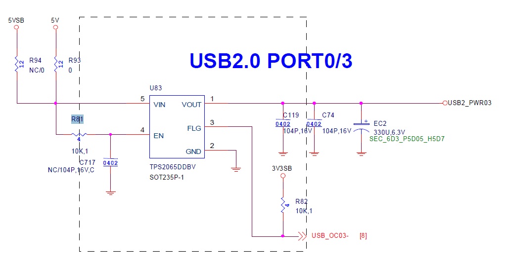

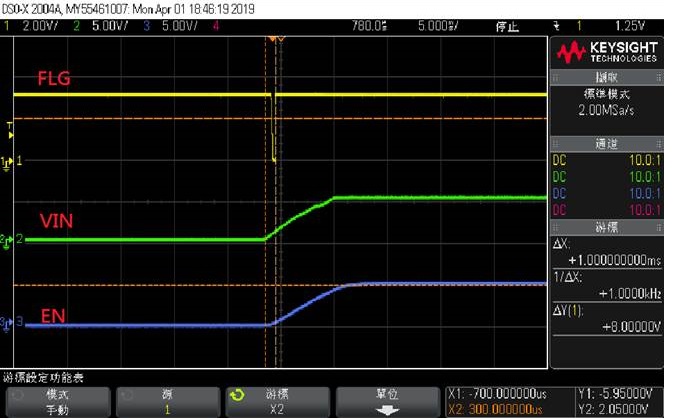

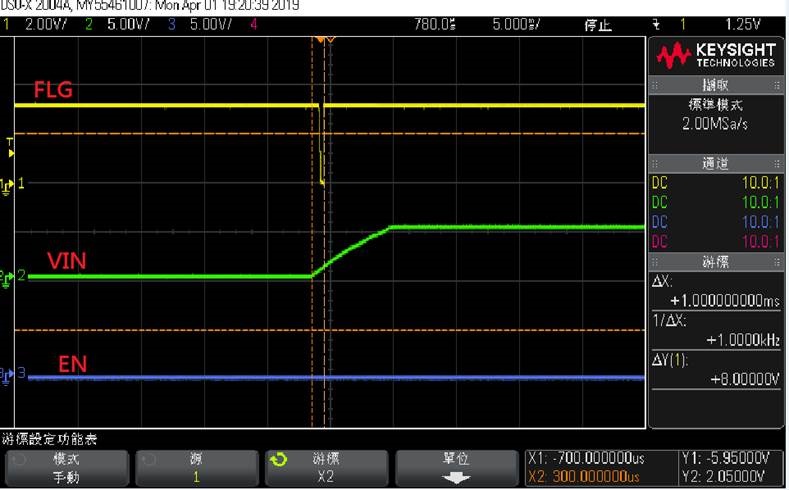

                 The Fault pin was pulled down to low during VIN was applied no matter EN pin is high (condition#1) or low (condition#2).
There is no device connecting to the USB port and the trace of USB_OC03- was disconnected. Please find the schematic below, thanks for your support!
Condition#1
Condition#2

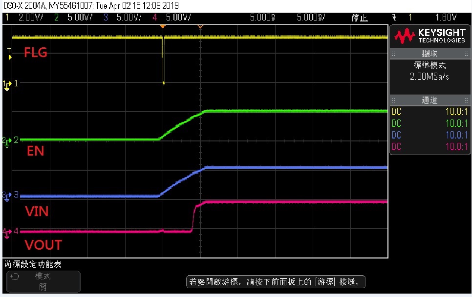

Added Vout waveform: the period of low pulse is around 300us.
