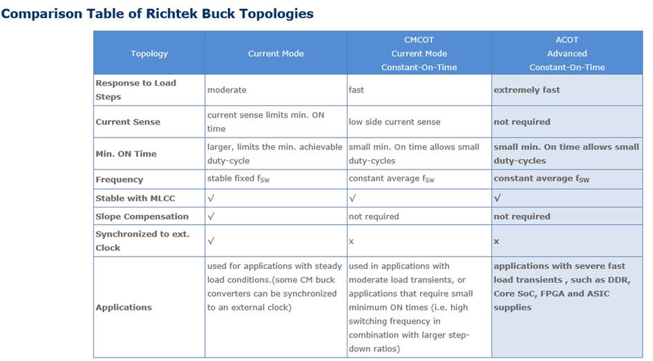

Hi team
My client requires a buck topology comparison table.
Richtek provided a buck topology comparison table to the customer as shown below.
Does TI have similar data?
If yes, please share.
Thank you
