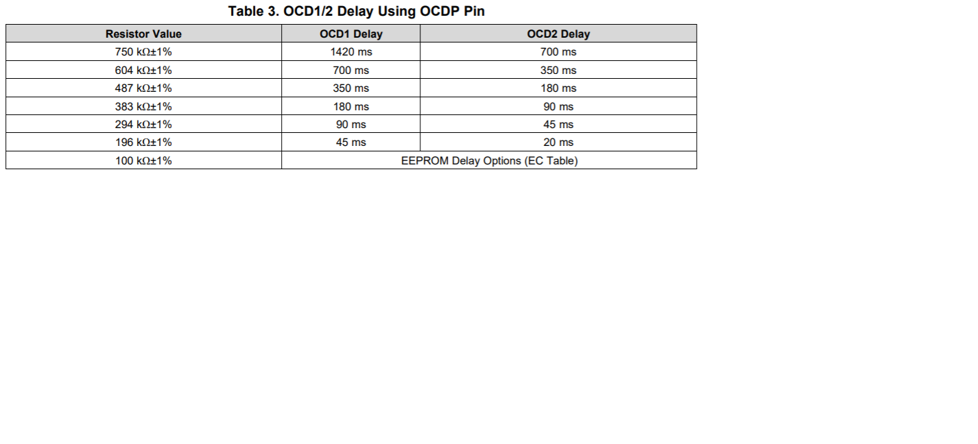

Dear Sir,
I would promote BQ77915 to replace RICOH_R5436T, but customer said about OC delay time would have 5sec,
R5436T can adjust by external cap(CT1, CT2).  BQ77915 delay time 1.42Sec(max).
BQ77915 have any method to programmable OC delay time to 5Sec? or have another device can be suggestion.
Thanks!
