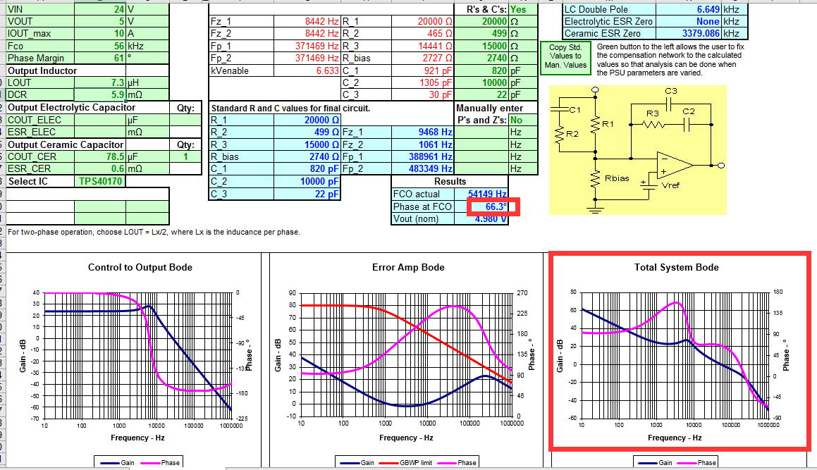

I fill in the reference board data in TPS40KType III Loop Stability.xls but get a different bode plot
Which data I fill in is wrong?
47uF: 23.5uF degrade@25°C   5V  300Khz  ESR:2m ohm
10uF: 4uF degrade25°C   5V  300Khz           ESR:5m ohm
Cout:3x23.5uF+2x4uF     ESR:0.6m ohm
