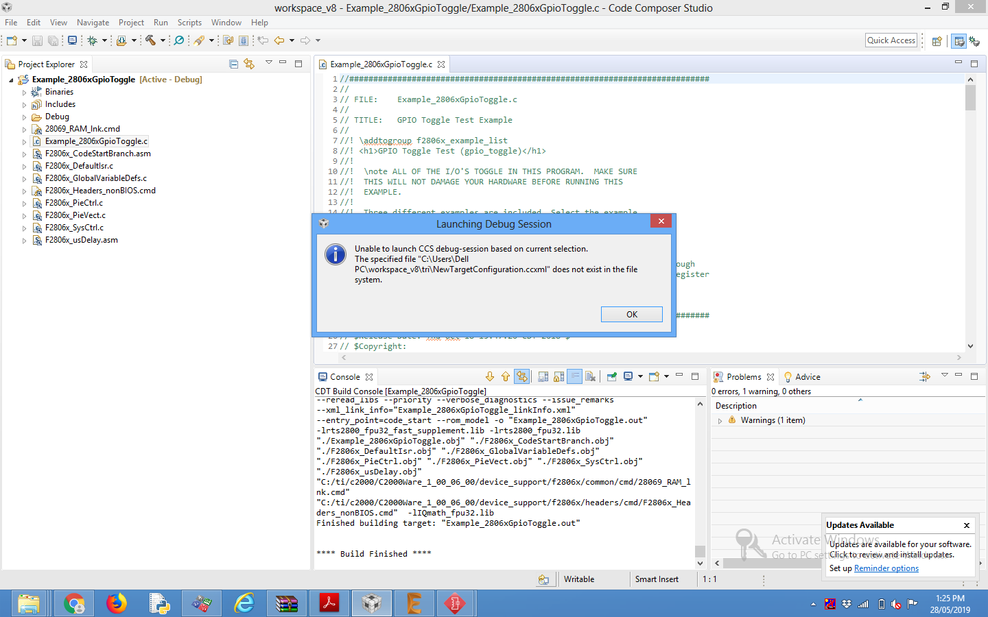

  •  Dear sir,
    I am using the example code of gpio toggle.
    I am able to build the code but not able to debug it.
  • Hitesh,
    You need to set up a target configuration. For the controlSTICK:
    Open the emulator target configuration dialog box. On the menu bar click:
    File -> New -> Target Configuration File
    In the file name field type F28069_ctrlSTK.ccxml. This is just a descriptive name since multiple target configuration files can be created. Leave the “Use shared location” box checked and select Finish.
    In the next window that appears, select the emulator using the “Connection” pull-down list and choose “Texas Instruments XDS100v1 USB Emulator”. In the “Board or Device” box type F28069 to filter the options. In the box below, check the box to select “controlSTICK – Piccolo F28069”. Click Save to save the configuration, then close the “F28069_ctrlSTK.ccxml” setup window by clicking the X on the tab.
    To view the target configurations, click:
    View -> Target Configurations
    and click the plus sign (+) to the left of User Defined. Notice that the F28069_ctrlSTK.ccxml file is listed and set as the default. If it is not set as the default, right-click on the .ccxml file and select “Set as Default”. Close the Target Configurations window by clicking the X on the tab.
