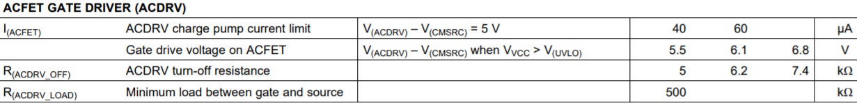

    Can I know ACDRV pin's source and sink capacity?
    It'll be helpful if I can't find out similar part of CSD17308.
    Thanks!
  • Hi Bill,
    ACDRV is a charge pump output which drives ACFET and RBFET. The current limit is 60 µA, as shown in the table below.
    Angelo
