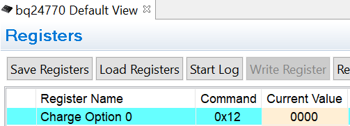

3.)  I tried executing the Procedure Step 3.2 “Charge Regulation and System Load Checks.” But I could not execute step 3.2.1: For SMB Mode: type in “810E” into the 0x12 address and click Write.  I am not able to "Write" anything.  The "Write Register" button is grayed-out in bqStudio  and when I go to "Advanced Comm," I arrive at a window labeled "Advanced Comm I2C.  There is an I2C Master Control Panel that has "Write" and "Read" buttons.  But, am I not using the SMB version of this EVM (bq24770EVM-540)?  How do I use bqStudio to get this EVM to charge my battery line up?  Right now V_bat is stuck and around 9V and I_batt is zero.  I am able to set a system load and vary the load current, but I can't get anything happening with my batteries.
How do I write to my bq24770EVM-540 with bqStudio?  Please let me know.

  • Hey Carl,
    To ungray the Write command button, Update Mode needs to be set to "Manual" instead of "Immediate".
    Joel H
  • Hi Carl,
    In addition to Joel's point, here are a few other points to address some questions in your document:
    1) You don't need to use the "Advanced Comm" window. The "bq24770 Default View" window is sufficient to work through the User's Guide.
    2) You can type "810E" into the 0x12 address by clicking on the "Current Value" cell (0000 in my screenshot).
    Angelo
  • Angelo, thanks.  I am now able to read and write my bq24770 registers.  Please see my next posting at: http://e2e.ti.com/support/power-management/f/196/t/807034
