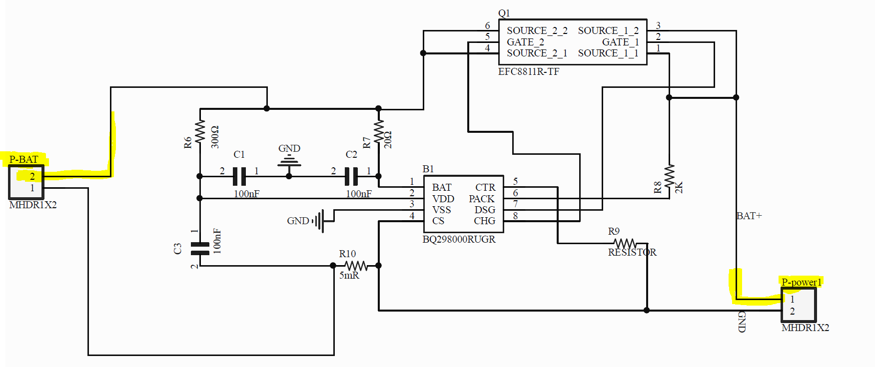

hello i designed this schematic but it doesn't work, in pcb i made it 4 layers with a plane for BAT- and another Plane for GND, i don't if is there were the problem comes.
what do you mean if i tied my GND ?
it's connected to BAT- through R10. or should make same unique net GND for BAT- and GND ?
