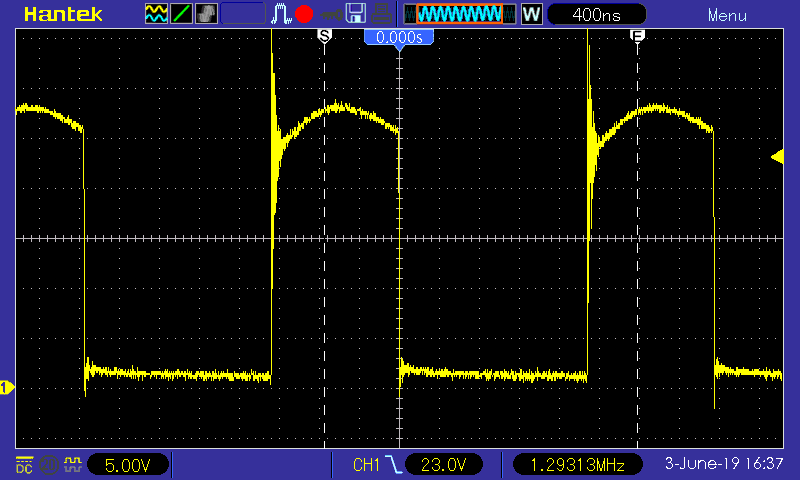

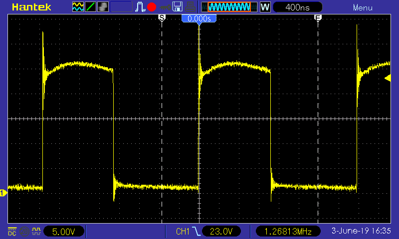

Using a 12V 2A coupled inductor reference design, and at low output currents <400mA it runs well with no immediate side effects. Once we go over 400mA things change rapidly. At 1A it is getting very hot (cannot touch the coil) within approximately 30 seconds. If we try at 2A it is getting to a similar temperature in around 15 seconds. The output voltage appear OK, it just overheats and its mostly the coil. The Mosfet is heating up too, but the coil is most noticable.
Looking at the VSwitch waveforms at the different currents I can't help but feel they aren't right. The unit is running at the design frequency of 320KHz.
The above is with a 50mA load.
This is a 400mA Load.
Above is a 900mA Load
Finally a 2A load.
The loads are all resistive only, with only some lead inductance and capacitance.
Any hints? The coil tests OK for basic conductivity tests it is a Bourns catalogue product and unless the batch is faulty I have others with the same results.

  • Hi Ken,
    Thank you for using the LM3488.  It looks like a flyback design, right?  The first two waveforms look typical flyback DCM but the voltage plateau is not flat, indicating some problem in your circuit.  The last two look like CCM waveform but again the voltage plateau is not the typical flat top. Can you share your schematic?  I am also afraid your transformer selection may not be proper to support your power level.

  • Hi Ken,
    You configured the circuit in a SEPIC,  but the schematic does not match your previous description.  Is you output 12V@4.5A or 2A?
    Anyway, according to your schematic, your switching frequency is set at 300kHz.  From your waveform I guess your input voltage is at about 8V.  Do a quick calculation by following the LM3488 datasheet SEPIC design procedure,  your component selections do not meet the datasheet recommendation: your inductor peak current is ~5.8A, and the secondary winding RMS current ~3.16A, both exceeding the inductor rating.  So, you should select a different coupled inductor.    In addition, the Sepic ac capacitor should be >2.5uF according to the datasheet,  but your selection is only 1uF.
    Could you update your design per the datasheet recommendations?
    Youhao
