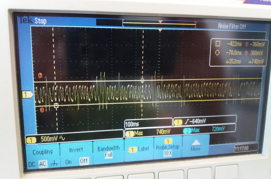

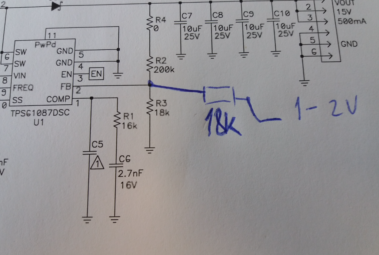

I'm using TPS61087EVM board for 15V output (input 3V) load 40ohm
 and I added 18k resistor to FB pin and  trying to regulate the ouput voltage with voltage to 18k ohm from 1-2V
Regulation works but the output has ripple about 500mV. I there any way to reduce the output ripple?
thanks answer
