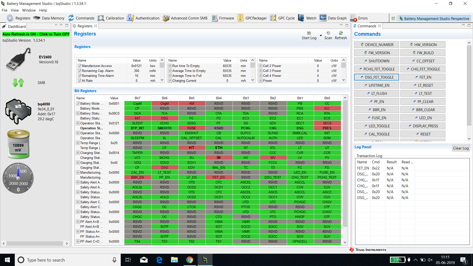

These are my register values:

Note:
Even though there are commands in the commands panel, those are not working in this case(they are not able to make changes in hardware).

  • 1. Yes, you will need to first characterize the cell and get the CEDV parameters before you start gauging.
    2. Please send the FE_EN command. Your fets are not enabled as seen in manufacturing status.

    As you mentioned in the earliest reply I do send the FE_EN command which you can find on the command log panel.
    I send a set of commands after the FE_EN command like DSG_FET_TOGGLE & CHG_FET_TOGGLE and I observe the terminal voltage each of the above cases but there is no difference at all.
    Note :
    PRECHG_FET is working in all the above cases.
    some commands like DEVICE_NUMBER, DEVICE_VERSION and LED_TOGGLE are working fine and replying the same.
    FET_EN command was not able to make respective commands on the registers which you can find in the picture above.

  • Himavanth,
    Your FET is enabled. You can clearly see that FET_EN is set in manufacturing status register. However you have fuse asserted. Drive the fuse pin low. You should be able to chg or dsg.

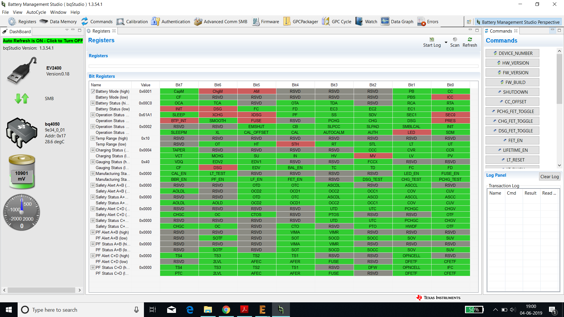

  • Hi Batt,
    Thank you for your reply.
    As you mentioned in your reply FET's are in on the condition,  I can understand that by CHG_TEST, DSG_FET & PCHG_FET(as these coloured green. i.e HIGH) in manufacturing status.
    1. What about the FET_EN(that should be HIGH as of my knowledge, if not what is the case?) in the manufacturing status ?.
    2. I tried set of commands to toggle DSG and CHG fets but the terminal voltage is the same in all cases, is it issue with the grounding the fuse?
    Thanks & regards
    -Himavanth
  • 1. Yes. It should be 1.
    2. Yes.
