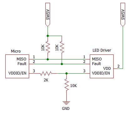

In our system, MCU uses 5V power supply and LP8860 uses 5V for VDD. SInce LP8860 uses VDDIO/EN as digital reference and VDDIO/EN is input from MCU,we are faced with following condition:
1.MCU GPIO output min=0.7*5V, LP8860 output min=0.7*VDDIO/EN, In worst case the output can down to 0.49*0.5=0.25V which is lower than the MCU H level threshod.
2.We use 5V to pull up LP8860 output:Fault and MISO(SPI communication) to make sure H level can be recognized by MCU
3.According to previous answer: LP8860 has an internal ESD structure forms body diode between FAULT and EN/VDDIO,I guess also between MISO and VDDIO/EN. As a result, when VDD voltage is rising to 5V, VDDIO/EN is also pulled up to a certain value while MCU output still keeps low. And if I cut the connection between MCU and VDDIO/EN, the VDDIO/EN can rise to over 2V which is obviously over the enable threshod.

Rough image for our circuit:
    Please refer to below comments.

    3.How can we make improvement for our design to decrese the unexpected rising?
    We recommend to pull up the FAULT pin to VDDIO/EN, not VDD. In this way, the unexpected rising can be avoided.

    Regarding the third question, we scarcely use one MUC output pin to pull up another input pin for some concern of current consumption and uncertain status during power up.
    Is there other mass product use this kind of design in vehicle  electronics?

    Regarding the third question, using GPIO from MCU (usually can provide few mA) should allow enough current to use VDDIO/EN supply and pull-down current for Fault pin.
    Fault pin pull-down current will depend on resistor used. Let's assume VDDIO 3.3V, if 10k is used then only  0.3mA will be require for pull down pin which MCU GPIO should be able to provide. For no fault condition, FAULT pin is open/floating and just pull-up high to VDDIO/EN voltage.

    1. Since there's a diode directly from FAULT pin to VDDIO/EN, the delay will be quite short, much less than 500us.
    2. The VDDIO/EN input low level is 0.4V. The input high level is 1.2V. Only when the voltage is below 0.4V, it can ensure a logic low. If the voltage is between 0.4V and 1.2V, the status is uncertain.
