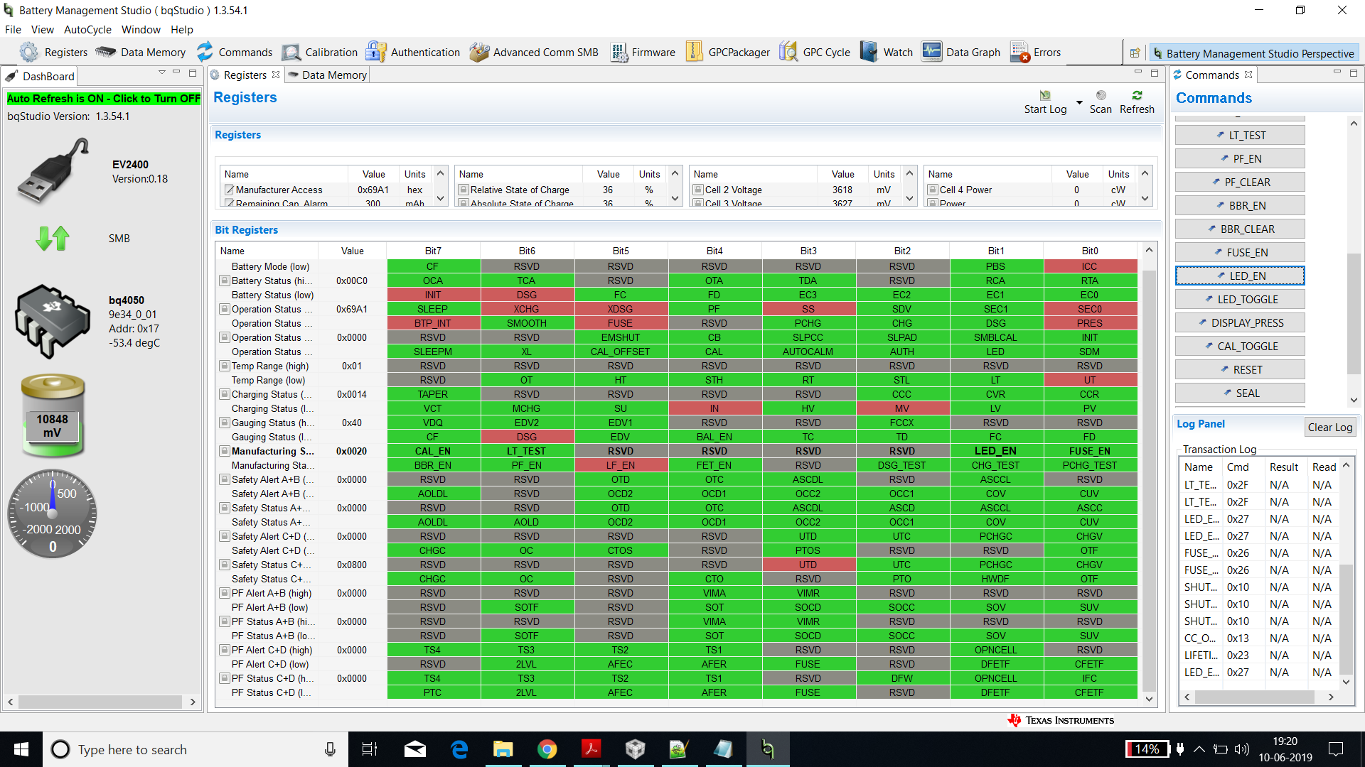

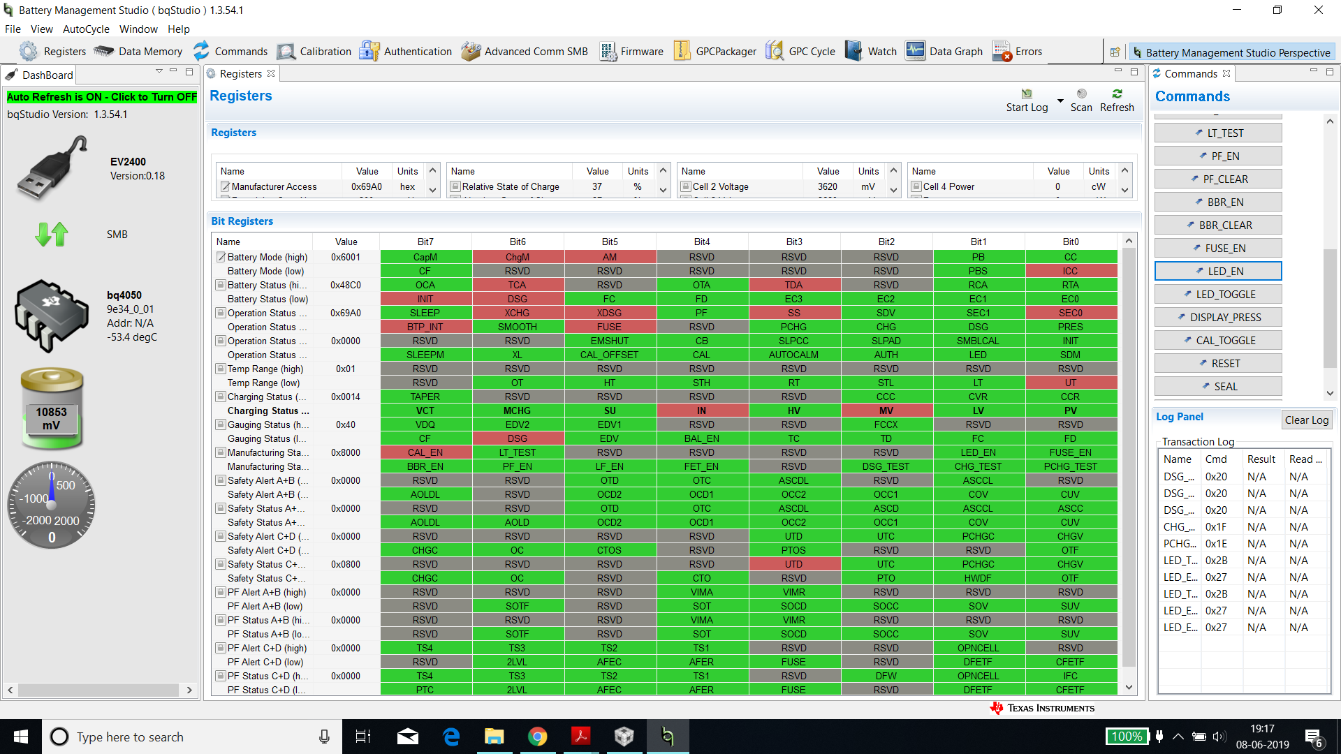

  • Hi Batt,
    I am able to detect my kit on PC as I removed one of the IC on the board.
    I can you look into my registers and tell me why my recharge FET(DSG_FET) is not working.
    In my case, FET_EN, CHG_FET, DSG_FET bits in the manufacture status register is HIGH, which means FET's should be on right?... But in my case, it is not.
    In my circuit, I left the FUSE pin floating. If I connect fuse pin ground board is not detecting completely.
    please help me out to get out of this problem.
    Thanks & Regards
    -Himavanth

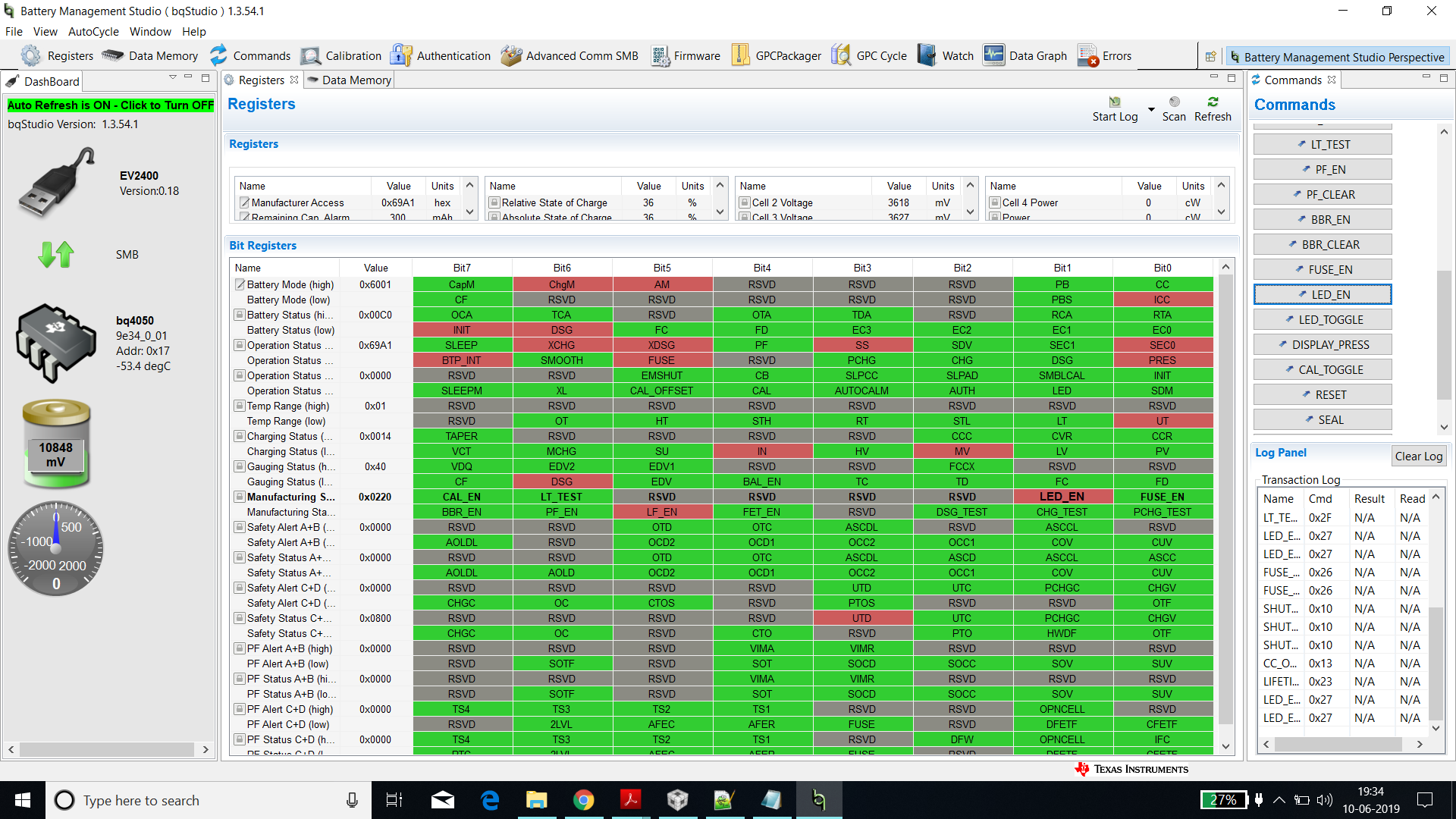

  • Hi Batt,
    I am using the custom circuit from bq4050 datasheet.
    I had a strange situation in case of LED handling on the BMS.
    1.  When LED_EN in manufacture status register HIGH:
    when I pressed the button connected to DISP pin it should blow_up, but in my case, it is not.
    2. When LED_EN in manufacture status register Low:
     As LED_EN bit in manufacture status is LOW, so when I pressed the button connected to DISP pin it shouldn't blow up. right!
    1. are my assumptions are correct in both cases? if my assumptions are correct then tell me why is it functioning in the reverse order?
    Thanks & Regards
    -Himavanth
  • Hi Himavanth,
    I see that your temperature reported is -53.4C. You are in UT condition and in this state, you also have FET_EN off per your registers here. Set the gauge to use an external thermistor or an internal thermistor at room temp. You can then use the FETs.
  • LED_EN is a toggle command. Looks like you have disabled it first.

  • Hi Batt,
    I connected FUSE pin on the bq4050, that gives me correct functionality.
    When I tried to connect my BMS to the EV2400(with FUSE connected to GND), shows no communication found, I think my BMS got damaged(not sure need to check) when I soldered Fuse pin to GND.
    Finally resolves my issue when FUSE connected to GND properly.
    Thank you once again. Great Support...!
