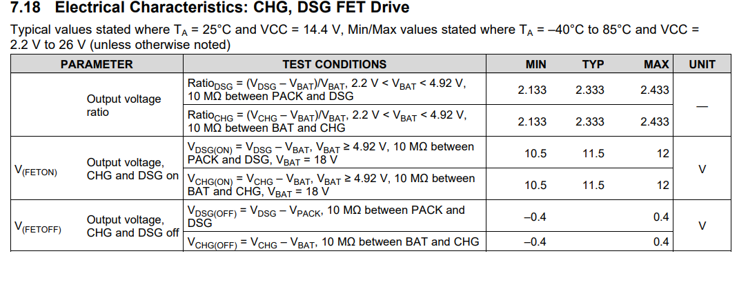

i Have problem in bq40z50r2 in measure Voltage in R8(DSG) from schematic not same in R11 or R3 (CHG).
what should I do to solve this problem?

If you're using the bq40z50-r2 schematic from teh DS, R8 is the resistor on the PRES pin. That's maintained at a high voltage unless you want to press the shutdown switch to shut the gauge down. As I mentioned R11 is the gate drive to the chg fet. It will drive high when the fets are toggled. You need to send either the FET_EN or CHG_FET_TOGGLE command to turn it on.
