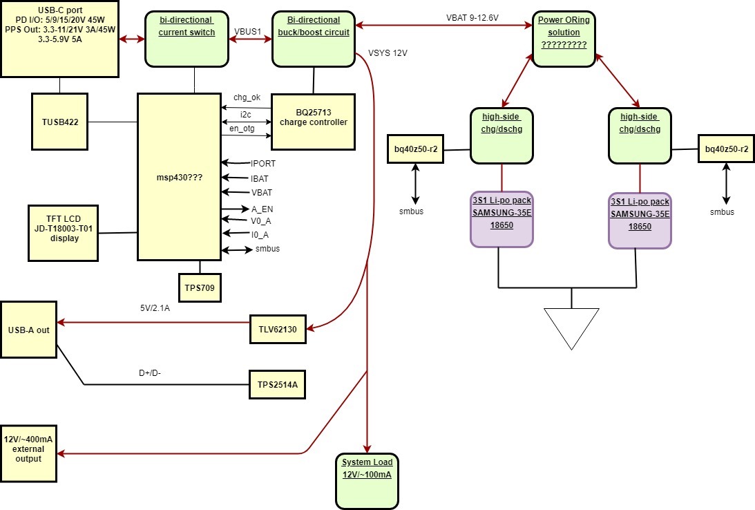

Hi, I am currently working on a charger/batterypack for use with a portable measurement solution.
I have drawn heavily from the pmp40441 reference design as I have based the charger off of the BQ25713.
I am modifying this design to include a small lcd display for diagnostic info (cell voltages, charge current, etc...)
Thinking of using the BQ40Z50-R2 for the battery monitoring side of things and here is where my confusion begins.
I am using custom battery packs consisting of INR1860-E35 (samsung 18650 3500mAh) in a 3s1p configuration,
using the BQ40Z50-R2 as the monitor/gauge will give me the diagnostic data I want, but not the capacity I need.
We have gone with 18650's as the main cells because this particular system is portable, and downtime is costly,
we needed something that was high capacity, rechargeable, and available on short notice.

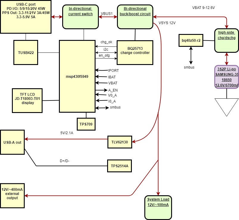

I know I could simply make a 3s2p pack using one BQ40Z50-R2 and I would get the capacity I want and be able to read the (3) cell voltages from the pack.
The issue here is I want redundancy and also the ability to monitor every (6) cell individually. I'm confused about how to get this to work with my current setup.
I know I need to use some kind of power ORing to isolate the packs from each other, but how do I go about getting this to work?
These packs will be installed and calibrated at manufacture, so I don't foresee too much of an imbalance between packs, but I need assurances that if cells in one of the packs is replaced and the new cells are at a different charge than the other pack the system can handle this. Can 2 x 3s1p be placed in parallel utilizing 2 BQ40Z50-R2 as individual pack controllers, can the voltages on both packs be different and still charge/discharge the way the system expects? How do I go about achieving something like this or better-I am open to ideas.
