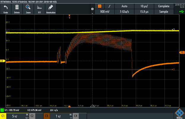

We have an issue with the +15V rail overshooting due to an instability/resetting issue. The +15V rail can overshoot by over 1V (see plots below). This has affected about 20% of our PCBAs thus far. We’ve so far replaced two of the faulty parts and this has fixed the problem, therefore the issue does not appear to be layout related. We are in the process of checking that the fault follows the part onto a board which does not show any problem. The faulty parts have also been X-rayed on the PCBs to check for soldering issues/coverage. The problem goes away if the be part is cooled on the board using freezer spray directed at the IC.

Fig1 (good board): +15V output rail ripple +/- 30mV.

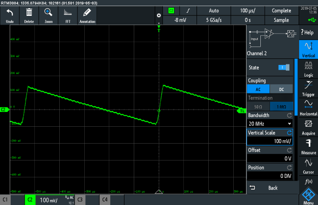

Fig 2 (bad board #1): C1 = +15V output rail (overshooting by ~1V).

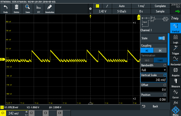

 Fig 3 (bad board #1): CH1 = +15V output rail; C2 = switch node; C3 = inductor current
Fig 4 (bad board #1): CH1 = +15V output rail; CH3 = inductor current - note output current being dumped back into input.

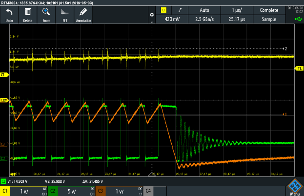

Fig 5 (bad board #2): +15V output rail with 250mV overshoot.
  • See below for scope plots noted above..

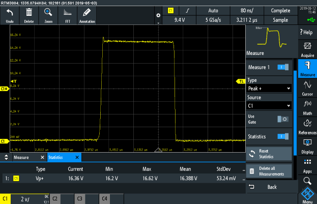

  • Fig 6: 'INP' (+15V) switch node at 300mA load

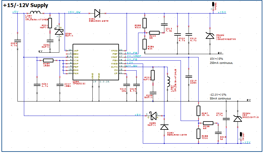

    Thank you for your detailed problem explanation and scope plots. Can you please also share schematics of the TPS65131 section of your design?
    Also, if you verify that the this issue follows the TPS65131 device in an A-B swap i.e. good board becomes bad and bad board becomes good, we may need to get one or two of the problematic device back to debug this further in our labs.

  • Hello Liaqat,

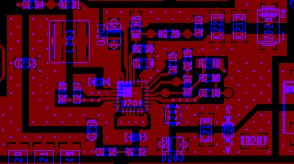

    Thank you for looking into our issue - please see below our TPS65131 schematic and top layout (layer 2 is an uninterrupted ground plane).

  • Hello Stu,
    Capacitance at boost and inverting buck-boost converter output is lower than than recommended int he application schematics in the datasheet. Your schematics shows less than 10uF and datasheet recommendation is for 22uF so you can try to add capacitors in parallel to  C221 and C212.
    More importantly though, I requested some one in product engineering to look up the lot code information you provided and his response is "I did a search for the Lot Trace Code and didn’t come up with any results.  That means they could be counterfeit parts".
    So it is a real concern. Where did you purchase these parts?

  • Hi Liaqat,
    Thank you for your feedback.
    We've already increased the value of the capacitor on the 15V rail but it didn't fix or improve the issue - but will check again.
    I've also experimented with changing most of the other component values (inductor included) to try and find out if there is any sensitivity to component variation but with no improvement.

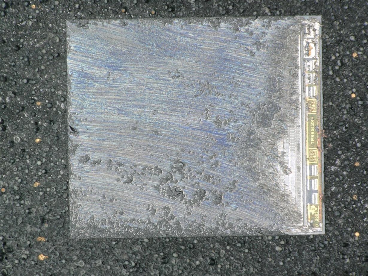

  • Liaqat - please see two X-ray images below of faulty part before being removed from PCB..

    I am not aware of the counterfeit parts in circulation but it is possible. Our QA engineer could not find any information for the lot code you provided and every lot produced by TI is traceable.
    TI logo is not supposed to be on the package of this device.
    I think we need to wait for the devices from Digikey to see if any of those exhibit this issue. These devices seem suspect to me. Also, let's see what the results of AB swap are.
