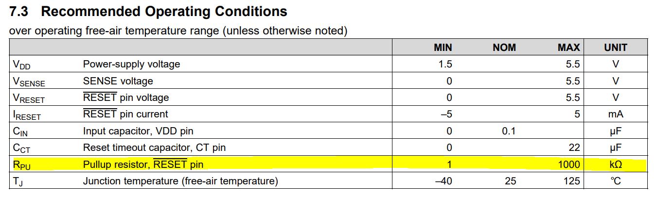

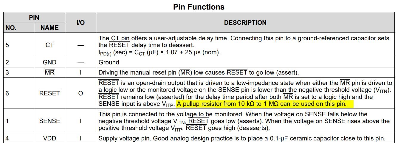

I would like to know about Rpu and tPD(t) of TPS389033DSER.
Could you answer questions below?
1. According to Datasheet, The range of Rpu values is different between ”pin functions” on p. 3 and "Recommended Operating Conditions" on p.4.
which one is correct?
(Please see the figure below)

  • Hi Y.Ottey,
    To answer your first question, they are essentially saying the same thing as 1000 kΩ is equivalent to 1 MΩ for the top end, so I assume you meant the minimum resistance, which differs at 1 kΩ in the table vs 10 kΩ in the pin functions. The minimum is 1 kΩ but we recommend at least 10 kΩ.

  • Y.Ottey,
    We generally recommend 10 kΩ pull up across our devices. As listed in the datasheet, you can get by with a 1 kΩ as the minimum and it should not cause any issues. Using a higher value could mitigate issues with heat from current draw. This is a very wide range between 1 kΩ and 1 MΩ, so it really depends on how you prioritize your strength of your pull up resistor.
