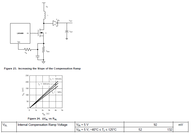

1. Figure 24 shows the relation between Rsl value & Vsl voltage.
    The other side Vsl volatge is defined 52 to 132mV on the datasheet.
    iF Rsl = 0 ohm, 52 to 132mV will be maintained?
    Or any protection will be activated?
2. I wonder Vsl setting will affect to Vsc(short-circuit CL) voltage?
H. Sakai
  • Hi Hideyuki-san,
    The 52mV to 132mV internal compensation ramp voltage is internal to the IC itself and not dependent on Rsl. If Rsl is involved, then the current limit will be changed since you are adding a ramp to the inductor current across Rsen.

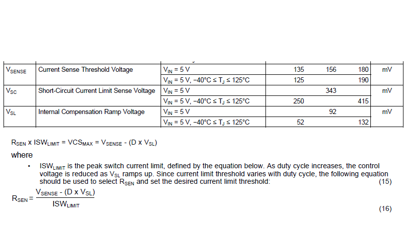

    Page 22, formula (15) is referred Vsense.
    1. I wonder Vsense means the spec defined on Page 6?
    2. If yes, there are 2 type of Current Limit, normal & short-circuit?
    H. Sakai
  • Hi Hideyuki-san,
    I've formatted my answers to your questions below.
    ANS: Vsense is defined as the voltage that will trigger the cycle by cycle current limit. This is different than Vsc, which is the short-circuit current limit sense threshold voltage.
    ANS: Yes, you are correct- there are 2 types of current limit. Normally you will trigger the normal cycle by cycle current limit which is set by Vsense, but you can hit the short-circuit current limit if you exceed the threshold set by Vsc during the blank-out time of the IC. Further detail can be seen in section 7.1 of the datasheet here: http://www.ti.com/lit/ds/symlink/lm3488.pdf

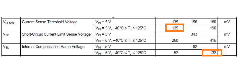

    I would like to make sure the relation between Vsl & Vsense.
    According the definition on the datasheet, Vsense min. = 125mV
    and Vsl max. = 132mV. So, if this combination was existing,
    cycle-by-cycle CL would be always activated.
    Is there a any relation or tendency between Vsl & Vsense?
    Please give your advice.
    H. Sakai
  • Hi Hideyuki-san,
    Vsense is not a constant value and can change as a function of the internal compensation ramp. You can see this in section 8.2.1.2.4
    Vsl represents the maximum amplitude of the slope. The addition that you are seeing is dependent on the duty cycle so your case may not actually be feasible.
    However, if you are dealing with extremes, it is advised to not use the maximum and minimum limits of Vsense and Vsl. Instead, the electrical characteristics table has a relation between Vsl & Vsense called Vsl ratio.
    You can use that and eq.18 in tandem to approximate a reasonable Isense limit or Rsen range.
