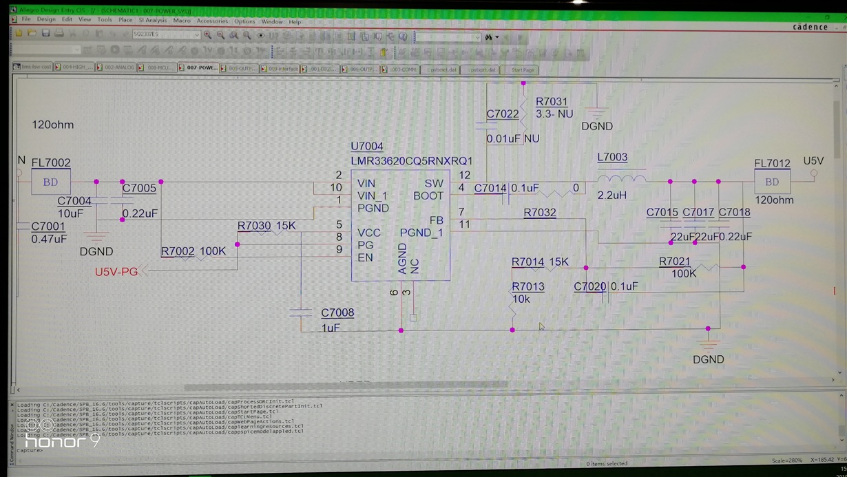

Could you please help check the LMR33620-Q1 schematic? Thank you!

Hi Sherry,
Better to use one lower feedback resistor to optimize the layout. Also, you can put a cap after the output ferrite bead.

It looks like you are using the 5V fixed device in your schematic.
In that case you would not need a FB divider. Not sure what output
voltage you are looking for?
Also, this looks like the RNX package. In that case you will need
two high frequency input bypass caps on either side of the package.
Please see the recommended PCB layout in the data sheet.

What's the recommendation value about the cap(after the output ferrite bead)? What is the cap's function?

Hi Sherry,
That cap just provides additional post-filtering and lowers the impedance to the load. 10-22uF is sufficient.
