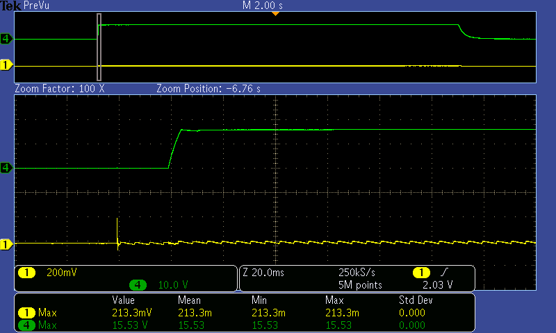

  • Hi, David:
                    Please refer attached photo, CH1 is Vcomp,CH4 is Vcc
    Vcc voltage is normal, but Vcomp haven't voltage
  • Hi Yang,
    Is the waveform happens at the moment UCC28019 failure?
    I do not see any unexpected signal from your waveform. the Vcomp and VCC all under the absolute maximum rating. the Vcomp depends on the output power, so if the vcomp keeps near zero, the output power is at very light load.
