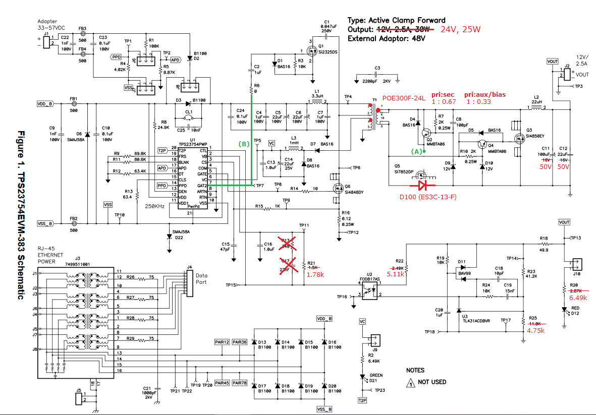

Hi Brett,
I still hope to use the active clamp forward topology. tried to modify the TPS23754-383EVM implement to 24Vout, from the -420 EVM circuit to modified to the -383 EVM circuit,
Please refer to figure,
How to connect as (A)?
(B) Is this Gate2 going the original path?
Please check it out for me, there are no errors, thanks

Hi Kevin,
Please see attached which might make it easier (visually). But i recommend modifying the -420EVM since it is a flyback topology. There would be too much to modify if the -383EVM.
The diode looks backwards also you still need to modify the bias winding since it's now a flyback design. The output inductor is also much too high for flyback.
